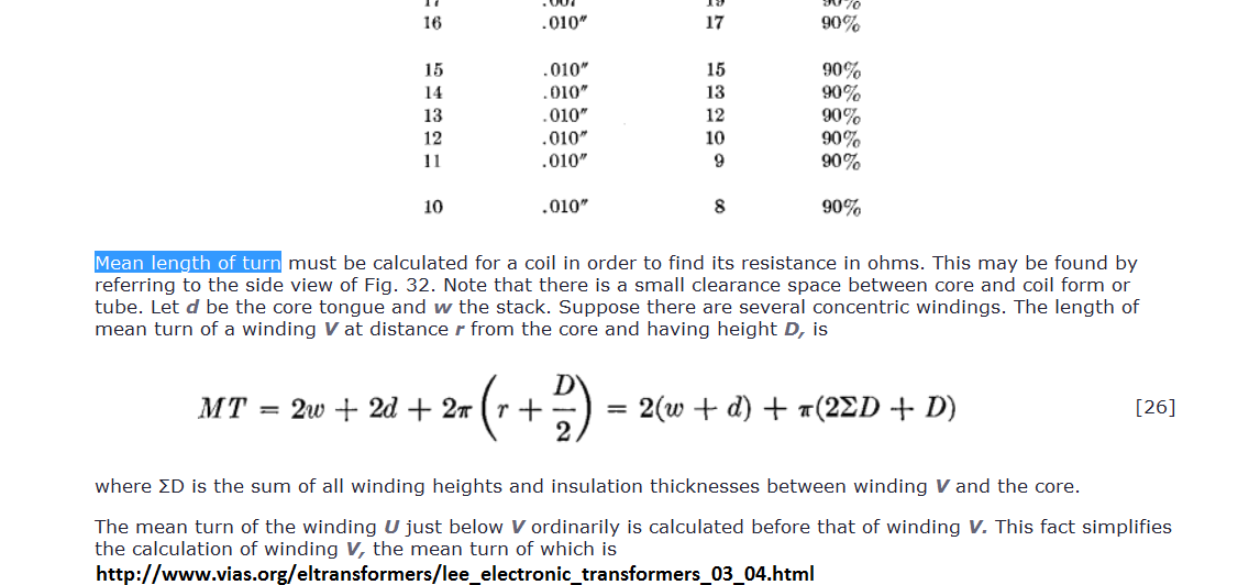

                          Bistander, previously...you wrote:
                          Sure, you need circumference, or more correctly, LMT, which stands for Length Mean Turn. Shop talk for the average length of a single turn on the coil of that size and shape. Then the LMT times the turns per coil (usually N) equals the total wire length in the coil.
                          Where did you get that term Length "Mean" Turn from...? I google it and all hits I get is Lockheed Martin Corporation Stocks (LMT Stocks...and Wikipedia (your always consulting source) gave me "Licensed Massage Therapist"...on another hit I got "Laredo Morning Times"...are you from Laredo?
                          Hi Ufo,
                          I was able to find various hits on google for Length Mean Turn, or mean length of turn, or mean turn length in the context of electric coils. Many were from old text or engineering books but several were fairly recent papers on motor efficiency and such. In my quote I stated it was shop talk. That was in reference to a job I once had with a company which designed and manufactured coils by the millions.
