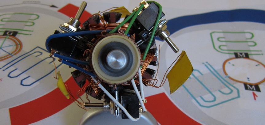

    • getting there
      i hope it doesn't disintigrate instantaneously
      just the final wiring for both symmetric and asymmetric modes to finish ... and mounting the magnets in such a way that they can rotate
      • Wtf?!
        Hello Seth...
        WOW, Man!!...WTF?...
        So, you have switches to jump from Symmetric to Asymmetric?...If I understood correctly?
        We must "propose" this set up to Hendrik Lorentz and Associates...
        But it looks great...One Assembly, same wiring and...Both Worlds!...great idea!
        You are saving a lot of extra time and money!
        Just make sure your switches do not create high resistance between circuits when they are closed (Symmetrical way, right?).

          yes you understand perfectly.
          coil start and end wires go to the two centre poles on the switch.
          thowing the switch with change coil commutator contacts from symmetric design to your design.
          then rotate magnets to complete mode change and fire it back up
          switches seem to have very little resistance accross closed connection
          also i recieved my pulse fet driver board today but i'm going to need a scope.
          i have been offered an nice old analog one for $150 but i'm not sure if i should put the money towards a modern little digital one? any suggestions appreciated.

                              • sputnik ... thanks for your input.
                                just another scary pic for fun
                                connections nearly complete and still quite a lot to do before testing.
                                i'm worried its all going to fly appart catastrophically at some point lol
