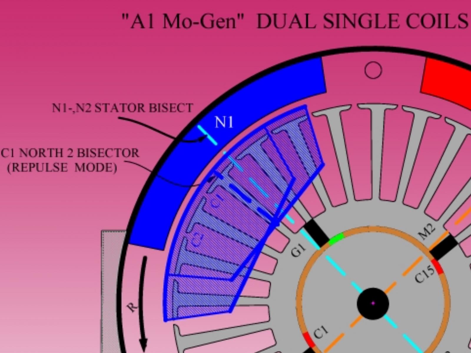

It is so simple to look at without ANY Commutator nor Brushes.The Commutator for this Motor is based on 56 Elements, NOT 28....Therefore, every Single Pair must attach to TWO Elements.
But this fact does not matter here, we are "fitting" the real magnetic interactions from Rotor within Stator configured Angles.
Rotor MAX Interaction Angle based on Two Pairs being fired at same timing
[/IMG]
Switches are VERY Relative here, We could install them anywhere... like shown above... Brushes turn, wires expand and reach connections to Comm elements...Commutators turn ...above setting is right at center of Pair Intersection...the MAIN SIDE To Observe here are the MAGNETIC INTERACTIONS taking place between Rotor Coils and Stators.
The only thing the switches are supposed to accomplish...is to Disconnect or Connect when they are commanded to do so.
I have set different positioning of brushes and comm elements here related to every machine different configuration settings...choosing the position would be better to adjust without major complications...making it simple for building.
This confusion you are showing...all is doing is confirming that all your previously built motors have also, something very and seriously wrong within their interactions/timing settings...reason why all your under performance readings.
However, I admire the fact that you DO have the 'audacity' (not to say the balls..
)... to start shooting at me,the bringer of this type of winding...and who have a few naked, Imperial Rotors in his Garage...plenty of wire and many, many Geometrical Angle Rulers, and software CAD'S , HD Cameras to demonstrate you ARE WRONG...
Please, think about all this...and do not waste my time insisting now on a Motor Structure you have not even started to work with...?

Twice you reinforce the point that P2 must be FULLY Disconnected.Originally posted by Ufopolitics View PostSo, on this Method We MUST TEST FIRST before engaging into Full Winding, by checking IF P2 and P16 (Leaving Pairs according to Rotation) get FULLY Disconnected BEFORE even reaching each related Coil#1 Bisector NOT TO ALIGN with South Bisector Stator!!!
That is the reason of magenta 'enclosed region' for CRITICAL TIMING SETTING
I have set Coil#1 in each Pair for being the one closer to Commutator Element to be connected to, as this would be the First Coil We start winding from each Pair.
NOW, IF WE DO NOT FULLY DISCONNECT P2 & P16 BEFORE IT REACHES SOUTH STATOR BISECTOR...WE MUST DISREGARD THIS METHOD AND SWITCH BACK TO PREVIOUS OVERLAPPED METHOD, WHICH OFFERS MORE ADJUSTMENTS.
We agree on the rotor geometry angles.
We agree on the stator geometry angles.
Agreed. The leading edge of the comm segment connects on one side of the brush and disconnects when the trailing edge of the comm segment leaves the other side of the brush. The brush width has to be considered in the equation because P2 has to advance over the brush before it can FULLY Disconnect.Originally posted by Ufopolitics View Post...
...The only thing the switches are supposed to accomplish...is to Disconnect or Connect when they are commanded to do so.
Please do not see this as shooting at you. It is important for others to understand these interactions. As a novice those many months ago I didn't realise this simple truth. Fortunately I wasn't designing motors, I was building them to pattern. Now I'm designing configurations and testing performance.Originally posted by Ufopolitics View PostHowever, I admire the fact that you DO have the 'audacity' (not to say the balls..
)... to start shooting at me...
Your quotes above make it clear that the 'ON' time starts from P1 just connecting to the brush to the time when P2 is fully disconnected from the brush. It is self apparent within those two criteria that the angle for P2 being on the brush MUST be added to the critical angles between the two relevant magnet bisectors.
I have been repeatedly accused of being unable to time my motors because I am confused. The simple fact is this...these factors are out of everyones control. All comm segments, in principle, are connected to the brush from the leading edge of the comm entering the brush to the trailing edge leaving the brush.

Yes that is just great we agree on those points-angles.Originally posted by HuntingRoss View PostTwice you reinforce the point that P2 must be FULLY Disconnected.
It was a 'typo', you are correct it is P1C2
Yes, great we agree again...
Ok, so it was good enough having three agreements in a raw...now I disagree with you..
...because you are just adding the 'switcher displacement angle' to the magnetic interactions angle...just because the "switch" is outside the 64.85 degrees from the EM Interactions taking place.(see image below as the one you are referring to):
[IMG]
[/IMG]
Let's stop 'jumping' from 28 to 12 poles Machines Mark...pls...let's keep on the 28 poles Imperial.
So on Image below...I want you to do your Math, the same "method"...and tell me the total angles that we have to adjust timing there...Obviously you overlook this image because I have uploaded on previous post, and you did not quoted at all...
[IMG]
[/IMG]
What about another commutator element connection from P1-P2 terminals?...plus brush rotation to meet the desired timing?
See below Image Mark...a closer approach to original argument-discussion,
[IMG]
[/IMG]
Now...are you still adding the Comm Element plus Brush displacement Angles on the Two Images above Mark?
What I want you to note by those Two Images (actually all three) above...is that the switching angles could be moved within an unlimited area regardless of the EM Interaction Angle, (not affecting it at all) so...could be after (post), within (Aligned to EM) or even before (pre-retarded) to our convenience, however, the EM Momentum displacement still, will be taking place within the specific/required Space/Time, which is actually THE SAME for All Three Images on this Post...
We are just changing "around" the "Switch" position, by stretching the connecting wires just 'a bit'...then moving the Brushes to meet those contact plates...
It is a completely relative "item"(the switching circuit)...just like we could set the actual, physical ON-OFF switch... anywhere we decide in any electronic/electric device or equipment...
Just hoping to have the 'final agreement'...

. But I don't see a lot more revealed in that. After seeing Garry's numbers, who I believe is a serious researcher, I am looking more at reproducing those numbers myself. After all it would be the mother load of free energy? Tesla's original energy multipliers he had in Wardenclyffe?
What has got me intrigued,assuming I did not miss an adjustment, is the question, "Is there a simple reason I did not see the drop-off of amperage in my motor?"
One major difference is quad stator vs. dual stator. I may either have to roll out my old radio shack conversions or make my dual stator GM motor tunable. Thats a big job.
Or get on to my Baldor 56 frame motors, which are dual stator, completely infinitely tunable.
Question for Garry: Just to confirm it appears you moved one notch off the Ufo recommended timing Position?
I guess its in his video, just need to rewatch as to whether it is before or after Ufo's recommended Top Dead Center timing mark.Last edited by sampojo; 05-04-2015, 03:31 PM.Up, Up and Away
