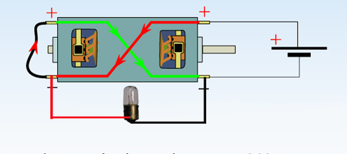

            Hello Everyone, Before I wind the 5 pole and do any tests there's something very important to be sure of. Is this the proper representation of how the bulb is connected in the regenerative acceleration under load test videos?

              Hello John,
              Yes, that is the correct connection.
              However, one important part to understand/realize, is that the Red crossed line-arrow does NOT means/represent a steady connection, but constantly pulsing/swapping all different Inductor/Coils within Machine Rotor.

                    Hello UFO, As you might have figured, I see something to question. Thanks for reminding me, but I'm fully aware of the brushes being there. Where I have a problem is most people looking at these recent videos really think it is a load on the motor that you are demonstrating. If I see it right the bulb is a load on the battery not the motor. Here is what I see and please correct me if I'm wrong.
                    Current will flow from the battery through the brush, across the coil, out through the other brush and back to the battery. This is a closed series circuit that doesn't have anything to do with generated potential from the motor. Correct me if I'm wrong again but couldn't you disconnect either side of the bottom wires and the motor would stop and be powerless but the bulb would stay lit. Of course you need to leave the wires attached to each other but not the motor and the commutator would have to be in the right possition. Is this where you plan to attach a load to the motor. How can you do that and call it a load if it's running from the battery. How many people here thought the bulb was lighting from the generator of the motor? Put up your hands. Now on the regenerative speed increase. I could really be wrong about this guess but you have the bulb in series with one of the motor coils and parallel with the other. Is it possible that a mismatch of resistance in the coils sends s little more potential down the path of least resistance and with one coil having more potential than it had previously it might speed up slightly? That's just a guess and I'll take it on the nose for it but it's just a thought. The clamp meter will always throw you a curve ball especially when it comes to skeptics. I saw the meter showing 100 to 150 ma when the bulb was disconnected a few times. Just an idea, did you ever think of using a precision resistor as a shunt or for that matter a shunt with a multimeter on it or just get an amp meter or another multi meter? If I'm correct about what I said then I think your videos are going to raise a lot of false hopes. If I'm not wrong, this leaves me with only a few basic tests and comparisons to the original motor with the exception of a load on the generator side. Unless I'm wrong again a load on the generator side is not demonstrated very often right? The same goes for a load across the generator coil attached in series to the motor coil. If you could do this without heavy current draw and RPM reduction then you really have something.
                              Ok, John...let's see if You understand this well...
                              Nope, Bulb will STOP lighting John, if you disconnect any of the rear terminals...BOTH Components of the circuit (Motor and Bulb) will STOP when disconnecting rear jumper.
                              Look at this Simplified Circuit of the same exact motor circuit John:
                              [IMG][/IMG]
                              If Switch S1 is Open (Rear Jumper Off) Bulb will NOT light up...can you see it now?
                              John
                              John, it is a Rule of Thumb...if your first "guess" or assumption is wrong...then all others based on first one will also be wrong...simple.

                                Sorry UFO but I have a NOPE for you too. I guess there could be some confusion about what I was calling the bottom. I'm not talking about where you put the switch on the drawing. Check my picture and I'll politely ask aging, because I could be wrong but don't think so. If this first assumption is correct then everything after it is correct also. If so, do you have misleading videos? Let me ask before you even evaluate the drawing: Are you openly claiming in your videos the the bulb load is running from the motor? From potential generated by the device and not the battery?
                                Now look at my modified drawing. Will the motor stop and the bulb stay lit?
