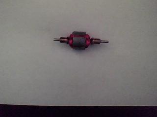

                            • This 50 turn motor runs on lower voltage than the stock RS motor even tho the resistance is a lot higher than the stock motor. I havent checked it for the "EFFECT" yet. This thread is getting more interesting all the time- RADIANT ENERGY RAYS?!!!?
