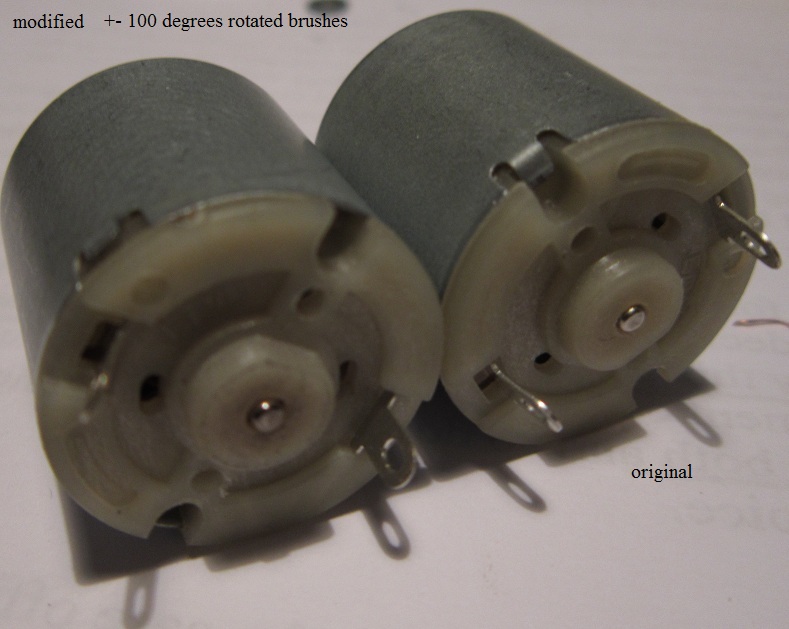

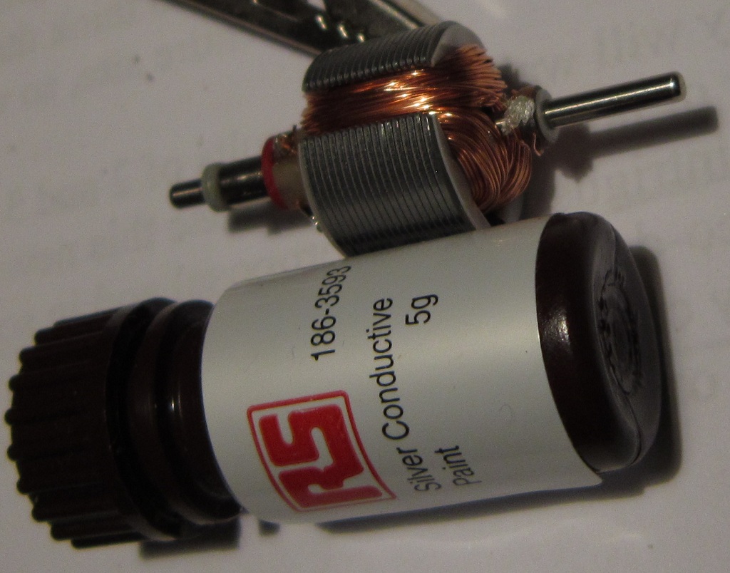

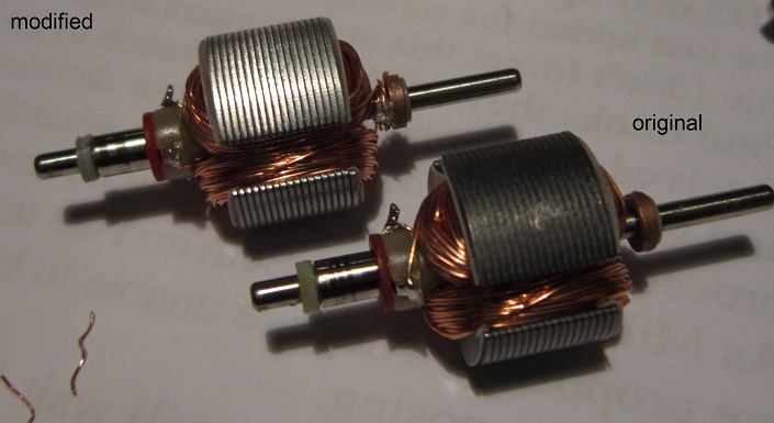

ok my first baby motor is modded
1.5volt hobby motors modded like suggested earlier in the thread avoiding destroying the second motor for case parts and brushes and the work modding the case itself.
1 wire at each coil cut, unwound half a turn and then connected to the shaft with conductive paint.
result no extra friction or weight really, no rewinding coils.
modded plastic end cap slightly to allow it to rotate.
90 degrees rotation resulted in sometimes not starting when power applied.
rotated +- 100 degrees now it starts every time no problem.
positive input in same connection as unmodded motor but the negative is now anywhere on the shaft
no further test as of yet as the setup is way to 'ghetto' at the moment
probably pretty useless for testing on these tiny motors anyway

Hello Seth,
I see you are doing the Mod as the low budget ones done before here, where you have joined all three coils at shaft to ground it...
This is "An Option" However, this Kills the Freedom at each Coil...as they will never be running independent, cause of bottom joint...plus you have Pos-Neg at just one Commutator..which it delivers kind off "Hybrid" between Witch-Princess"...
Seriously, this concept gets you away from results offered by the dual comm. and Motor definitively will overheat...

i'm totally not suprised its a terrible job ;-)Originally posted by Ufopolitics View PostHello Seth,
Regards and Cheers
UFO
anyway i'm just having fun getting my hands dirty
and displying how the 3 pole coils don't need to be completely rewound.
but yes its a terrible replication so please no-one do it like i have
i can still do it properly in a little more time...maybe can get a propeller and a means to measure rpm by then.
thanks for the inspiration
