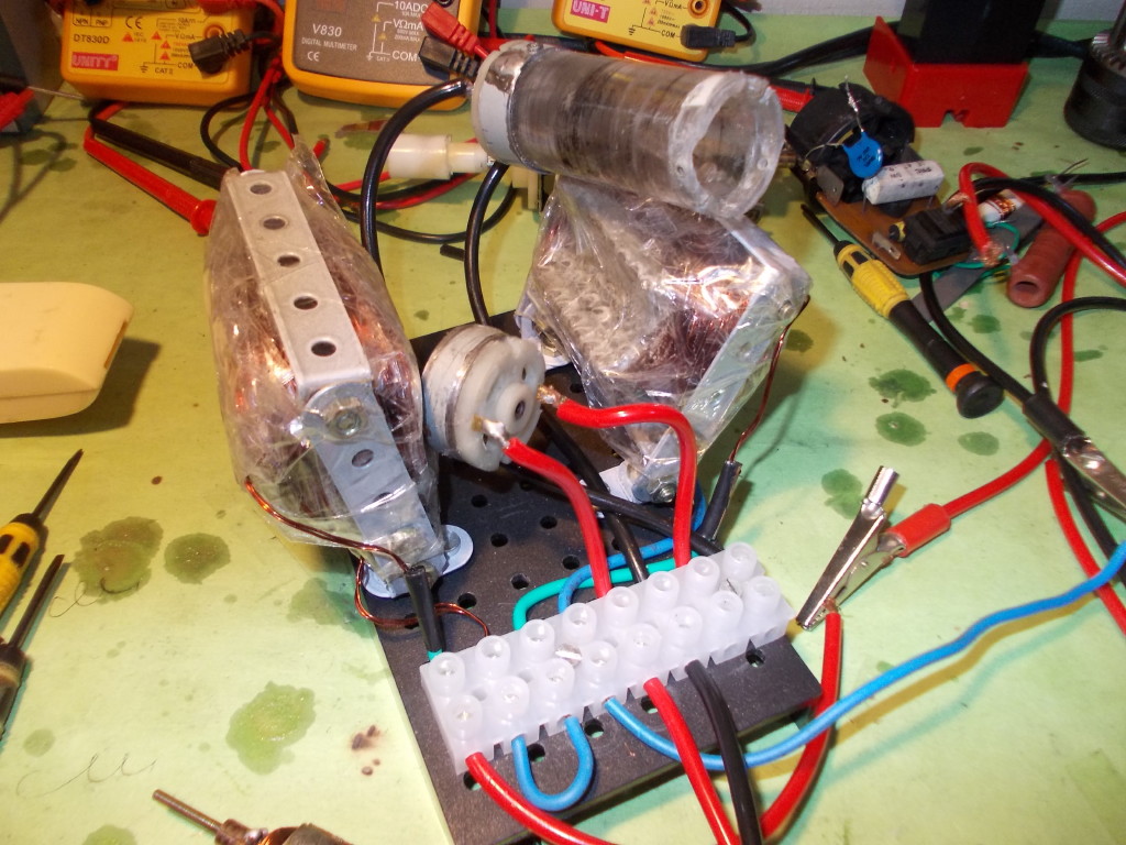

                                Hi UFO,
                                Thanks for the suggestions. I had tried some of these earlier, but was still getting arcing. Now unfortunately I have just "smoked out" this latest
                                build, which is a little discouraging. I will have to rewind the rotor again before any further experimenting and retrying your suggestions.
                                For the sake of comparison with other builders, I am finding that the best pulse rates are from between 5Hz to around 100Hz. Using frequencies any
                                higher than this, the motor does not rotate. The same applies to motors with permanent magnet stators as well as to motors with coil stators. Does this
                                sound about right?
                                For comparison with others, I am reffering to the small 5 pole motors, inverted-V winding, around 1.5 ohms per coil-pair. Voltage 10 to 16V aprox.
                                UFO, there's something else I'd like to try (after I've rewound the rotor). Please let me know if this makes sense or whether I am on the wrong track:
                                (This applies to 5-pole motors with stator coils.)
                                - Supply the rotor with ordinary DC (not pulsed). In any case the rotor coils will be pulsing at 5X rotation speed due to commutator action. And the commutator will always be "synchronised with the pulse".
                                Speed (and tuning) can be controlled by varying the DC voltage.
                                - Simultaneously supply the stator coils with pulsed DC - tuning can be done by controlling the pulse speed, in order to match the rotor.
                                Am I missing anything?
                                I've attached pictures of this motor dissasembled. I've also attached another picture of the overall setup, where you can see on the right the mosfet switching circuit and on the left a bagfull of the motors I've destroyed!
                                Best wishes
                                Anoop
