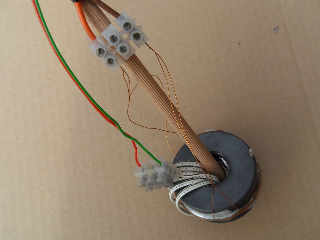

      the windings are .017" 25awg enamel magnetic wire parallel wound series connected bifilar. total of 17 turns.
      • #18
        just adding a few notes...
        total wire length is 10'
        this is an unbalanced circuit, as the capacitor plates are odd numbered there is going to be a miss match in the dielectric charge, this in-turn pulls from the ground. with the ground being on the load side the load is now in the circuit and needs to be balanced as well.
        70v is the maximum so far at 60Hz.
        need to adapt a number of capacitive equations and develop some capacitive inductive equations to model this.
        core field strength is ~480 uT
        Steinmetz capacitive M inductance equations with given results predicts a 0.8 T field to achieve the voltages given.

                plugging away, well the cores don't last long. shorting and arcing over to the windings is becoming a problem. need to move up to borosilicate glass and probably silicone or ptfe insulated wire.
                back to work...
                • #23
                  new core design,interesting result. Taking the B field of a capacitor and optimizing a layout to work in this strange circular field I came up with a log periodic array. I put together a simple 2 sector prototype, not calc'd just rough. It's the most effective layout so far.
                  did a quick layout in cad and will need to work on the calcs for the series. a number of parameters to account for, size, frequency, pulse duration, field intensity.
                  Eric if you're reading this it falls directly into your post on the log periodic. What I'm wrestling with though is the time variant or invariant electrostatic field movement that induces the magnetic field in a capacitor.
                  I'm still surprised by the simplicity of this and that is does indeed work. OK simple is relative, there is a surprising amount of calculations needed to make it efficient, but it's still simple enough.
