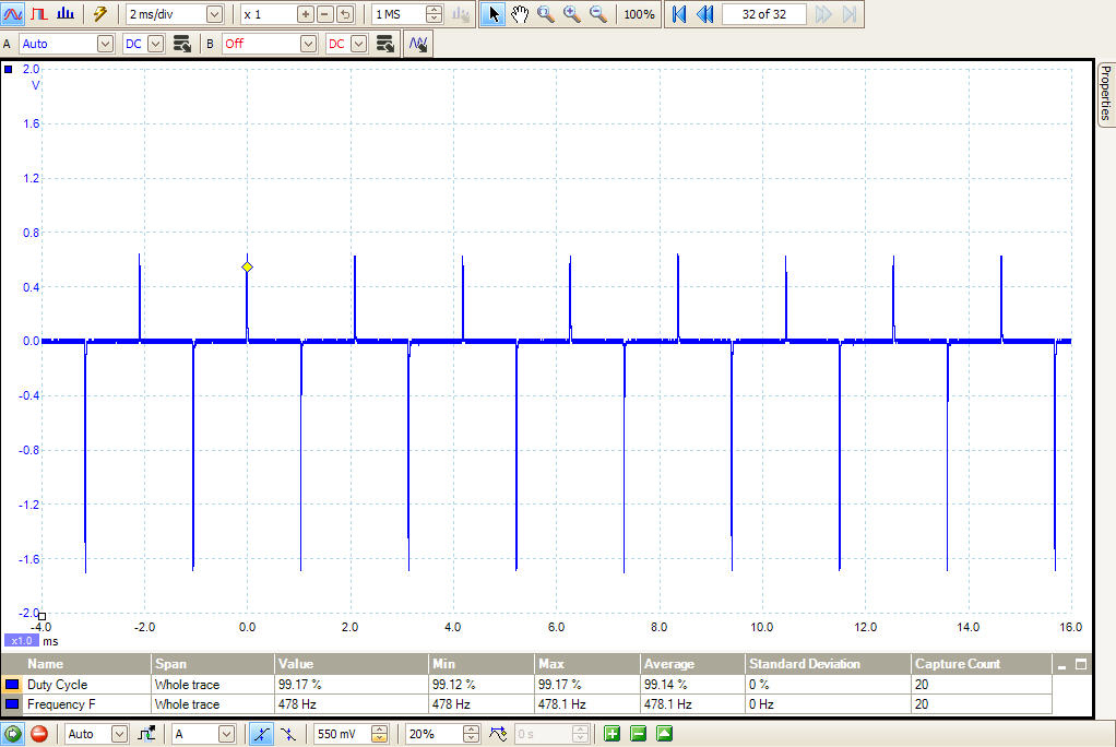

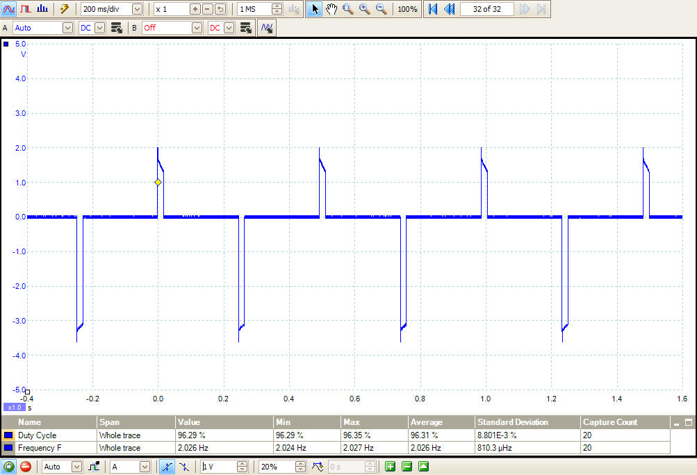

              • Scalar charger progress
                Hi gang,
                With the setup I posted earlier, I haven't been able to get a net gain in charge yet. I decided to try a separate battery to power the switching. The battery negatives had to be tied together for the transistors to fire. I attached two scope shots where the battery maintained a steady 12.12V. I ran it overnight with the lowest duty cycle. The battery was still sitting at 12.12v when I shut it down this morning. I will post the resting voltage when I get home tonight.
                In the scope shots, the negative of the probe was connected to the battery positive side of the load (#47 bulb) and the probe tip was connected to the cap positive side of the load. So the pulses in the negative direction show the caps charging in parallel across the load and the pulse in the positive direction is the caps discharging in series across the load (Correct me if I'm wrong). The bulb was barely lit in the 2hz scope shot and not lit at all in the the other scope shot.
                Is this the proper way and place to take the scope reading?
                @JB. Is this the waveform we are after?
                If there are other test points that anyone would like to see on the scope, let me know where/how you want the probe(s) hooked up in the circuit and I will post the scope shot.
                Comments? Suggestions?
                Alex

                  • Hi Alex
                    I also probe over the load. If you probe over the 2 caps it looks about the same, only the dc level change.
                    Use two bright 10mm white led`s in parralel but with polarities reversed as your load. You will see on the scope that the voltage pulse over each diode is about 3v. They flash very bright and at least give you the feeling that something is happening!
                    • Originally posted by hherby View Post
                      Alex
                      @Alex, the first wave form is the exact form that I am getting and the bulb is barely pulsing. I think your on the right track.
                      @Plazma, thanks for new ideas.
                      Bit's

                              I noticed that as well and noted it in post #1037. It must work considering all the potentials when Q1 is switched on. I'm sure JB would have posted a reply if it was a problem. He is meticulous in his work. There is something we may be overlooking/misunderstanding so we must build it "as is" to find out for ourselves how the potentials behave in this simplified circuit.
                              Alex
                                The resting voltage on the battery from my last test was 12.16v. So it dropped by 0.02v. I still have several other loads to try and will report on them.
                                Happy Holidays to all
                                Alex
