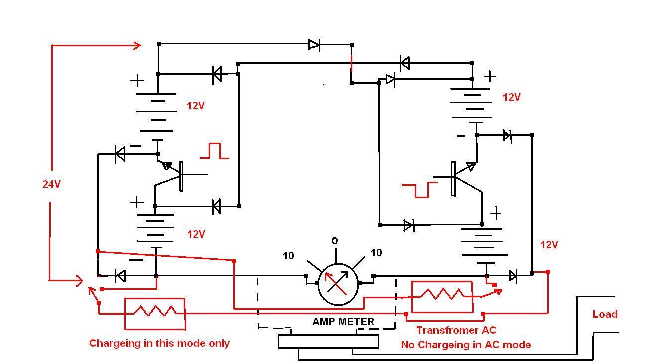

                • Tesla Switch
                  Ok,
                  I guess I should go over this again. The first thing I said to everybody is the three battery test was to show which way the potential goes.... I set up the three batteries with biased transistors, just two, the third you could switch so you could see what was going on in the circuit. I guess we find two things going on one with the four battery system and the other the Scalar charger. Both the circuits do the same thing one doubles the voltage and slams it back to the battery(Scalar Charger) but it is more then that as this one is a current charge pump. That pump drives things negative. The four battery system does the same thing but it does it buy putting the batteries in series then it slams the current across the paralleled load. This is very simple to do with two transistors and some diodes. The first part of this is how much potential can you move in a micro second before the current builds up in the circuit? Look at the drawing and see if you can see how you get the power out!!! I will be busy but I will check back.
                  John B
                  John Bedini
                  www.johnbedini.net
                  • Tesla Switch
                    Had to make correction, left one side off.
                    JB
                    John Bedini
                    www.johnbedini.net
                    • Thank You so very much - i have to ponder over that for a while...
                      Are the "charging only this way" loads pulsed so both sides charge eventually up, or are they just switched in, so one side charges up (like the 3 battery example)?

                      • I see the diagram as follow:
                        Without any red lines: Put the ammeter between the 2 negatives and adjust frequency and duty cycle till you get the least current flowing but still move potential. (The first part of this is how much potential can you move in a micro second before the current builds up in the circuit?)
                        If John actually means 1us pulses, that means 500 kHz. Very high. Or not? Maybe he means fast but not so fast. We will see by experimenting.
                        I think the part where he says: "no charging in ac mode" is, if you connect transformer in place of the ammeter but I can be wrong
                        Then the part with red lines looks like you have to use 2 small resistive loads to allow charging with both switches closed.
                        Looks like both modes, ac and charging, can`t be used simultaneously
                        Any thoughts

                        • The first part of this is how much potential can you move in a micro second before the current builds up in the circuit?
                          Nvisser@Without any red lines: Put the ammeter between the 2 negatives and adjust frequency and duty cycle till you get the least current flowing but still move potential. (The first part of this is how much potential can you move in a micro second before the current builds up in the circuit?)
                          I am thinking the way to find this is on a scope. As you turn the system on it takes time for the voltage to ramp up between the discharge and charge side. As a wave it would look like a ramp, slightly angled horizontal but mostly vertical.
                          At the point it goes horizontal, thats when you want to switch 180 degrees and do it again.
                          This would vary from setup to setup based on several factors. And could vary even from side to side.
                          Hmmm.. I think I need better tools...
                          Matt
                          • Will we connect the scope over one off the battery sets to see the voltage pulse while we adjust for the voltage to reach as high as possible and the amp meter as low as possible?
                            Or we have to make the duty cycle very small so only a voltage spike gets send to the parallel batteries and the rest of the signal is dead time? Then you can still use a low frequency.

                            • How to get the power out.
                              In post 1028 John B. asks how do you get the power out of the circuit he drew. I think I see how to do that. I don't have time right now to draw it out but I think you only need two more diodes and you can do it. If you remove the red lines John has added and then put a diode on the right side of the ammeter with the cathode to the right and another on the left side with the cathode to the left and then you need to connect them together without the ammeter in between. Now connect the cathode of the original diode on the bottom right with the cathode of the original diode on the bottom left. Now you can connect the load between the junction of the anodes of the added diodes and the cathodes of the original diodes. I hope this makes sense.
                              Thanks to John Bedini for trying to help the rest of us.
                              citfta
                              • Team, in my post #900, wouldn't this be the same circuit. I don't believe I have the load shown correctly and missing 2 diodes though. Thanks John for further inspiration.
