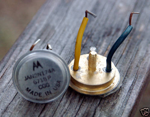

          • tranny
            John B what about this one
            I know it isn't what we talked about but
            it close to the others as discussed still looking for the other one
            Kevin
