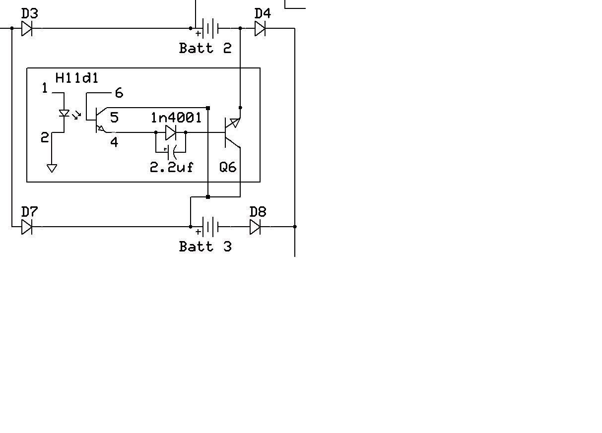

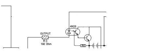

    • Originally posted by Bit's-n-Bytes View Post
      John, I think the Optos will work in the Jetijs circuit if they are configured like this.
      @Bits:
      No, that is not the way to do it. IMHO, the best way to do it, is to take opto-couplers that have the base of the transistor available at the outside, such as the good old TIL-111.
      Then, you can simply switch the tor inside the coupler and the power tor as a darlington pair and use a resistor between the base of the opto tor and the emitter of the power tor in order to improve the switch-off speed of the combination.
      John talked about "diode capacitor discharge on all the base circuits". Any transistor has a certain parasite capacitor at the base-emitter junction (and the collector base junction as well), which makes it stay "open" longer then you want to, unless you discharge this parasite capacitor. So, thatś why you have to add something between the base and the emitter to do that. I have done it like this in some experiments trying to make a solid-state Marx bank and it worked nicely using a resistor of 1 k for what is in the drawing as R5.
      Perhaps you can also use such a diode capacitor discharge. I haven't figured out yet how that is supposed to work, though.
      Anyway, this is how I would do it:
      • Oh, and remember you have two parasite caps to account for. One inside the opto's transistor, and one inside the power tor. You have to discharge both, otherwise your opto will ruin the party at high frequencies!!

        • Tesla Switch
          Iamare,
          I guess I did not explain myself with this circuit. If the load is in the collector it's no problem turning the transistor on, But what if the load is in the Emitter?, since the switch uses different potentials at different points I had to calculate the difference voltage between collector and emitter. when using the device as a cathode follower you will not get the voltage you need, so I use this method to force the transistor to discharge the most voltage between collector and emitter, a quick discharge without base to emitter resistor. The FET is the real problem with it's gate capacity. With this method you do not need a driver. However you do it anyway you want, I will stay with what I have . This switch uses inverted potentials in some of the devices and can be a real problem.
          Good Luck
          John B
          Originally posted by lamare View Post
          @Bits:

              Thanks Lamare, I did change it to this way;
              Bit's

              • Tesla Switch
                Bit's
                Do you mean this?
                John B
                Bit's
                John Bedini
                www.johnbedini.net
                • Originally posted by John_Bedini View Post
                  Bit's
                  Do you mean this?
                  John B
                  Yes, I caught the error just after I sent it. Thanks for checking up--More eye's the better.
