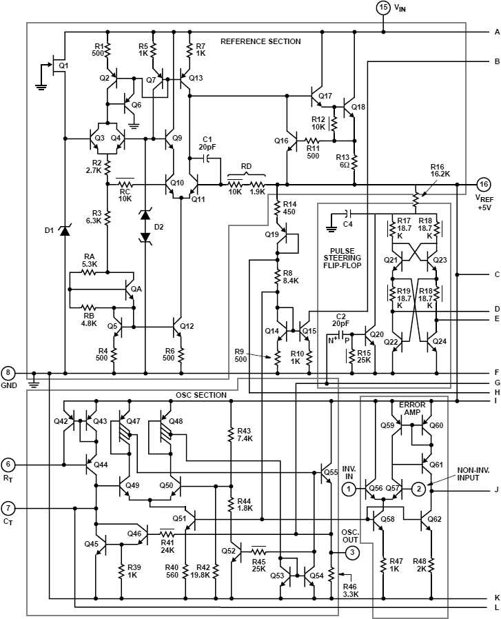

                      • Tesla Switch
                        Here is the fix for the SG 3524N, Just want you to have the information and the internal diagram for Harris, original RCA.
                        John B

                        • Not using 3524
                          John B

                          • John, I was just writing to ask you for SG details since trying to get it from PCB photo wasn't easy All I have at my disposal are 10000uF caps and MJE13005 or MJL3055 (not the best choice, I know) but I'm excited to get this working, like any of your previous designs. I also have a question regarding other circuit, if I could, but I don't want to hijack this thread.
                            Thank you
                            Vtech

                              • Tesla Switch
                                blackchise,
                                Those parts are fine to use, and no I will not answer any questions on the SG here as this is about the Tesla Switch at this time. Progress is made buy focusing on one thing at a time.
                                John B
                                Thank you
                                Vtech
