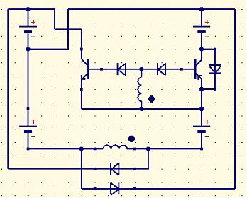

    My aim is the self-oscillating circuit below.
    Will hopefully get time to test it this weekend.
    Hob Nilre

                Well, this circuit works (nothing gets burned) but im not sure its beneficial (more effective than an ordinary circuit with one battery), its like 2 of Bedini's 3-battery-TS put together into one, so to speak, and if the load and the trigger are coils it self-oscillates:
                And I'm pretty sure this works as well, and if the load is a coil it should self-oscillate:
                Both circuits will never make a short-circuit, never, which, in my opinion, is one of the hazards with TS otherwise.
                /Hob

                      • nilrehob,
                        OK, I went back and drew your circuit with my mods again and I say for sure it doesn't simulate the same every time. To me that indicates a limitation in the code. Anyway if you get to foolin around with it, right click on a component and choose "view in scope" then right click on the scope display, if its a transistor you'll get a choice of what part to display in the meter.
                        There is a thread on this simulator...maybe I'll post some interesting sims there...the guy that publishes the simulator improves and updates his code pretty often...maybe we could get him on board and he could help us see whats going on inside these crazy circuits we've all been playing with.

                        • sigzidfit@
                          Thats a pretty nice simulator. I wanna look at the math in the code.
                          nilrehob@
                          Can you explain a simple little walk through of your cuircut? Fill in the detail as to why it won't short.
                          I appriciate it
                          Matt
                            Dude, it's like a bad video game...I've spent way too much time playing with it.
                            A Phenomenon is anything which can be apprehended by the senses.
                            • I believe ya. I am the same way with Vizimag. It doesn't have Java source code though. I like that.
                              Matt
                                The transistors work like a SPDT-switch:
                                * if current is going up through the inductor it will go through Da and into Ta making current go from A to C.
                                * if current is going down through the inductor it will go through Tb and Db making current go from C to B.
                                * if there is no current going through the inductor there will be no current through any of the transistors.
                                Current can never go from A to B, since current has to go both ways through the inductor to make that happen, and it will never will.
                                The inductor can of course be any signal-generator going between + and -.
                                /Hob
