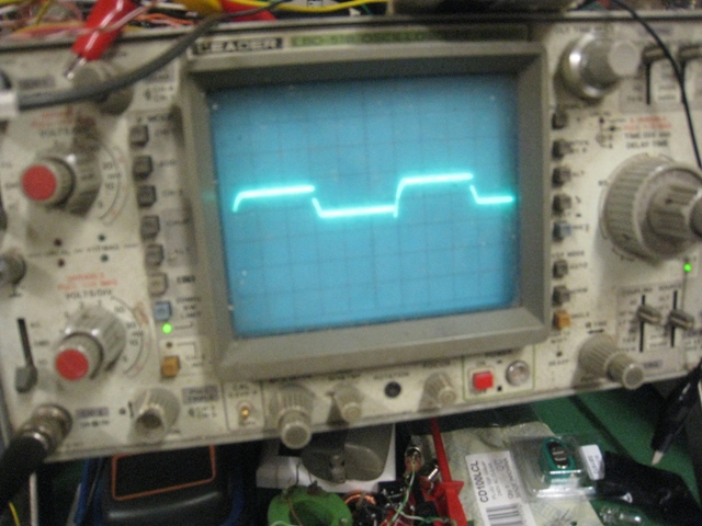

    I tried both programs on the simulator and they both seem to work. I had to adjust the timing on Bit's program slightly but Sobakin's seem to be dead on without any adjustment. I'll be able to tell better when I get back to running the TS and can look at it on the scope under real conditions.
    If anyone else is planning to use the Picaxe 18x you need to look at the timing on a scope because my modified Radio Shack transformer seemed to transfer the power to the secondary better after I got the timing pulses even.
    Carroll

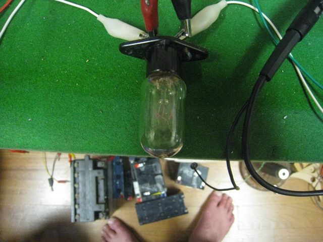

                            Sorry for not looking hard enough. Next time I'll open my eyes. Thanks anyway.
                            Well I banged it all together.
                            One of my SLAs is not holding up, so I'll get a newy in the morning. The lamp
                            (microwave oven bulb - 240v) lights ever so dimly. Using an off the shelf twin
                            12 v winds / 240 wind. Measured voltage from 240 side of transformer is around
                            19v. It takes a little while, maybe 4 or 5 seconds to climb there. I susupect
                            the bad SLA.
                            Do you guys disconnect your arduino or pic etc before making changes ?
                            So, thanks for your help and I'll report once the new SLA is in place.
                            Thanks, Garry

                                The arduino has now been disconnected from power for ten minutes, but the
                                base of the transistors still show pulsing. This is only a couple of volts, but I
                                thought it weird.
                                Rest of the wiring still in place and maybe cause its so messy using leads with
                                aligator clips, it maybe picking up rf.
                                Using an av plug, the leds light ever so dimly.
                                Weird huh
