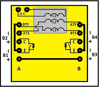

    here is the diagram for my build.

      The schematic is this one http://www.matthewcjones.com/power/SimpleSwitch.jpg.
      Don't read to much into it its just an outline.

        That build is mine. The out put is 3000watts. Matt was vary kind in helping me getting it to work!!! I hope to post some test soon. I did not used the right wire so I have to wind it again with #6 transformer wire. Matt is right about the heat in the transformer so use what he said to use.
        The caps I used are 18,000 uf x 7=126000uf
