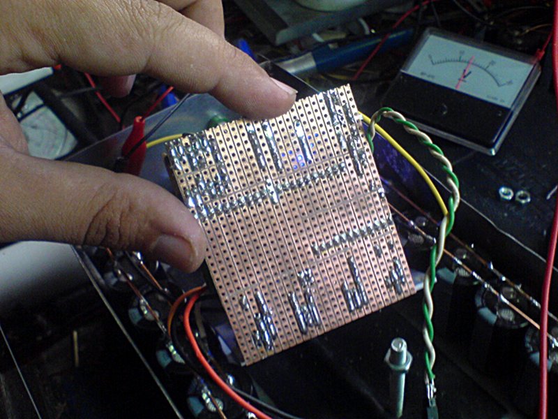

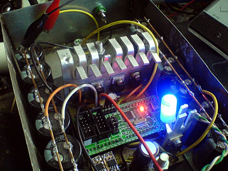

              @DoubleD,
              1. What's the difference of Rds(on) under near to maximum rated amperage in the function of gate voltage?
              1.1. And especially in time limited "out of spec " (=above) Amperage levels (100A for IRF3205)?
              (i suppose You can decipher a data-sheet?)
              HINT:
              what's the difference in between 12V and 18V of source to gate voltage level in regards of the ability of the MOSFET to carry current?
              "CHEWED UP" (=for layman):
              the BOOTSTRAP procedure requires a capacitor large enough to maintain full saturation voltage levels for the while the device is afloat in full conduction and under load.
              The limiting factors are the ability of the charging diode (1N4007 on my circuit) to deliver enough charge to a capacitor large enough (10uF in my cct) to sustain the "floating" period abowe both the undervoltage lockout and the most beneficial voltage (near Vgs(max) (is 20V in my circuit) ).
              In my case (420mces) is is simply not ample enough! My bootstrap keeps falling through the 9V level all the time!!!
              While on the other end (floating supply):
              A. We CAN easily produce a stable 18V
              B. We can find 9nsec/6A(and better) low side drivers more easy
              C. short leads driver to power-stage increase performance
              D. Complexity has to be somewhere, If we load itall to driver-stage, then the "brains" and power-stage remain bare and KISS (=good IMHO)
              So,
              IMHO:
              I. Floating supply of 18V rectified AC for opto-isolated (or opto-fed) low side drivers
              II. Floating driver stage of 18V +/- pulses driving the power-stage directly with co-axial (RG) leads of exact length with 20V (=10V-10W+10V-10W) Zener clamped MOSFETS.
              or we can't do it "just right"
              Stevan C.
              P.S.
              We didn't even come to consider the LOAD:
              It is a lowFVD transformer (300A rated primary?) with substantial core capacity (my gut tells me that..)
              That is a "beast of its own"...

                        • A picture is worth 1000 words...
                          And a motion picture is worth a 1000 still images!
                          The FET pulser in action
                          This is off my anciet phone, so expect nothinng really, its just proof i got it and it works...
                          And few still "shots":
                          (regards< Stevan C.)
