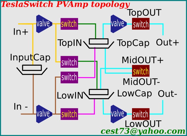

        • SeaMonkey and all:
          As we "speak" i run a series of thests in LTspice (version 4) and have reached few conclusions "as is" (without reachng the bottom of the sack yet):
          1. In the TS-PV-AMP configuration i wrote about before (links are in this thread) there are exactly seven (=7) switching positions of interest
          2. There are also exactly four "valve" positions of interest.
          3. There are in both switching and valve positions, parts that may be omitted and yet still retain correct operaion, as we all know by now (right? :B-) )
          4. If further parts be omitted (shorted out) the performance changes, but the operation is still a kind of "pulsing mode"
          5. In one extreme example, we can only keep the four valves and the "middle output" switch and have the lowest BOM variant (JB used a SCR there)
          6. In one other extreme, we can use four (4) MOSFETS with high side drivers and only two diode "valves" and get one really hard kicking (EMI?) bastard off (only) ~8000uF, but the problem is: the single "load diode" in between the buffer capacitor (near the PV/PSU) and the "hot buss rail" charging the (+) of the two cap-banks has spikes in excess of the 2x output peak (=bad) in my simulation = ~180A.this looks like calling for an array of diodes (10 or so?). This diode can be reffered to as the "input diode"
          7. In another extreme config, where all critical switching points are covered with MOSFET+driver, i can't get the upper drivers "boost" to charge: I need a "floating power supply" of 12V 300mA with 2...7 outputs (trafo windings). too complex IMHO, but sort of "right way"...
          8. there are two positions where switches unavoidably are subject to alternating current: the two "outermost" of the "input switches" go "inverted" the moment the output stage begins to "Que": as the two cap-banks get spawned "apart" voltage wise, the potential gets higher than the input and the MOSFET simply can't "brake" it to flow "backwards" (body diode).
          9. Only way besides putting a diode here (there is aconfig with four diodes and four MOSFETs better than this) is to use a SCR: the instant a "inversion" occurs, the SCR will lock out (zero line crossed).
          What gives?
          Please forgive me for lack of dravings, as this info is all preliminary (and early issue)
          Stevan C.
          • a basic sketch
            This is just the basic idea:
            (just to give my thoughts a "face" )
            • * I guess it is possible to swap the "valve" and "switch" blocks on the left side (four valves and two switches) and get same operation.
              I see now I have to make a series of this sort of charts (I'll be back later with more)
              * The yellow "texted" switches undergo alternating current loads
              * the dark red ones are "output"
              * the violet ones are "input"
              * I placed a input cap to be a part of the circuit (i think it belongs there for PV purposes)
              * in BJT config, the valves can be omitted
              * the input valves "suffer" twice the output peak
              Best regards,
              Stevan C.

                                There is a mosfet circuit earlier in the thread.
                                Host your images online with an easy to use image uploader, albums, photo hosting, sharing, dynamic image resizing on web and mobile.
                                We never got any follow up yet on it. He said it worked and I think at one time filmed it with meters but I am not sure about that.
                                Good luck
                                Matt
                                Yes, I have seen this particular circuit. It seems to be
                                a semiconductor implementation of the Brandt 4 battery
                                bank switching AC output converter.
                                What are your thoughts on this circuit?
                                From my point of view, it is entirely too complicated.
