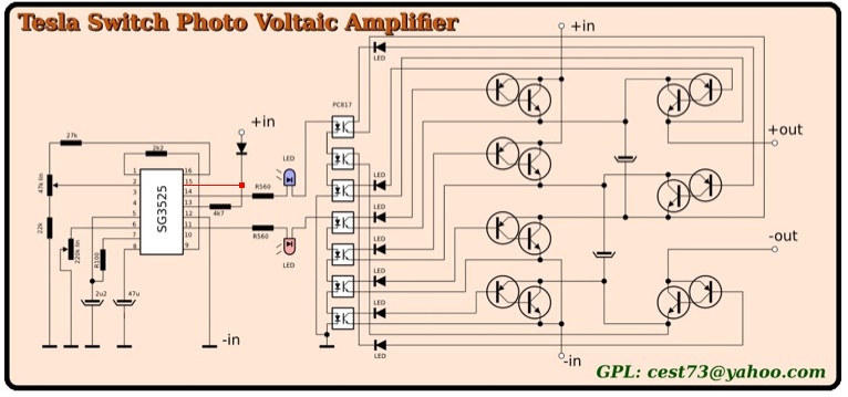

                  You got another problem in there. You have to prewire to understand but you are not going to be able to fire an NPN transistor they way you have the opto's hooked up. I am talking about T3 and T6. The rest look like they may work out.
                  You will have to pull power from the positive side of the battery to fire a NPN.
                  Matt, thank you for pointing me to that error. I was too busy to see it.
                  Made corrections and redo the PCB.
                  You may wanna go way back and review Byte's schematic for the TS. Your kind rebuilding the wheel.
                  Merely rounding it, man. I did what I did for the newbies (because I am one of them). We need something to start with (not bits or pieces of information).
                  Not everybody is a trained engineer, and we often speak a different language.
                  Trust me, it's very hard to digest all the info on this thread.
                  Bit's schematic is a little different now. Can't do. In fact I have not found any (was deleted or is out of quota).
                  Don't you think you should make provision for a load like a 2 x 12v primary transformer between T3 and T6 just for test purposes?
                  Thank you Vissie, I did, and made corrections. I hope it works well now (surely works in livewire simulation).
