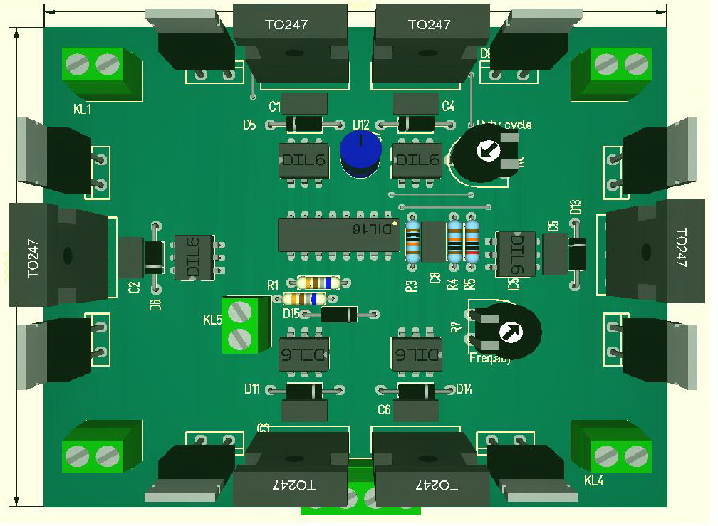

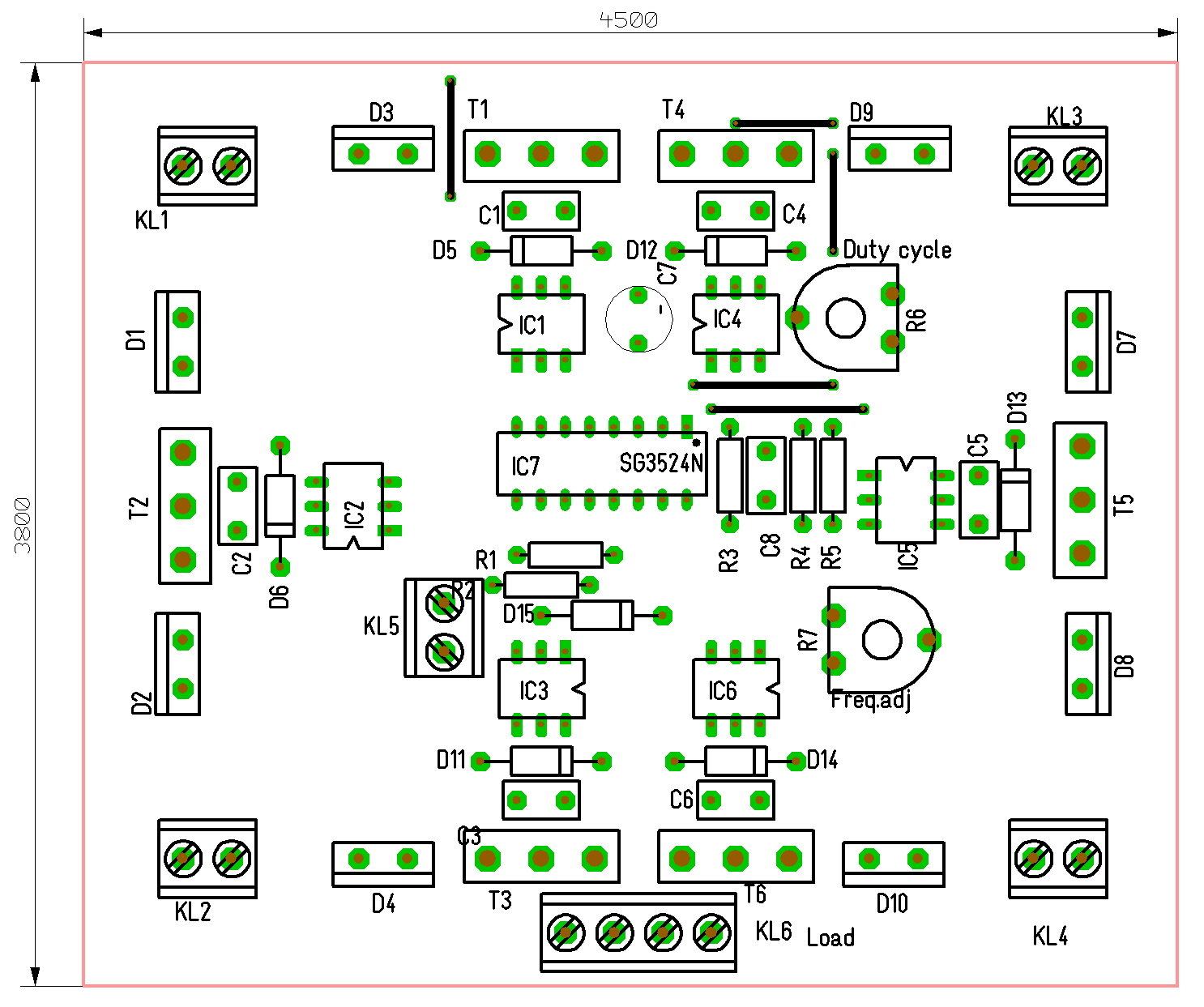

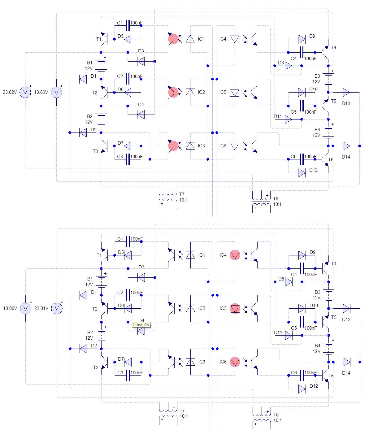

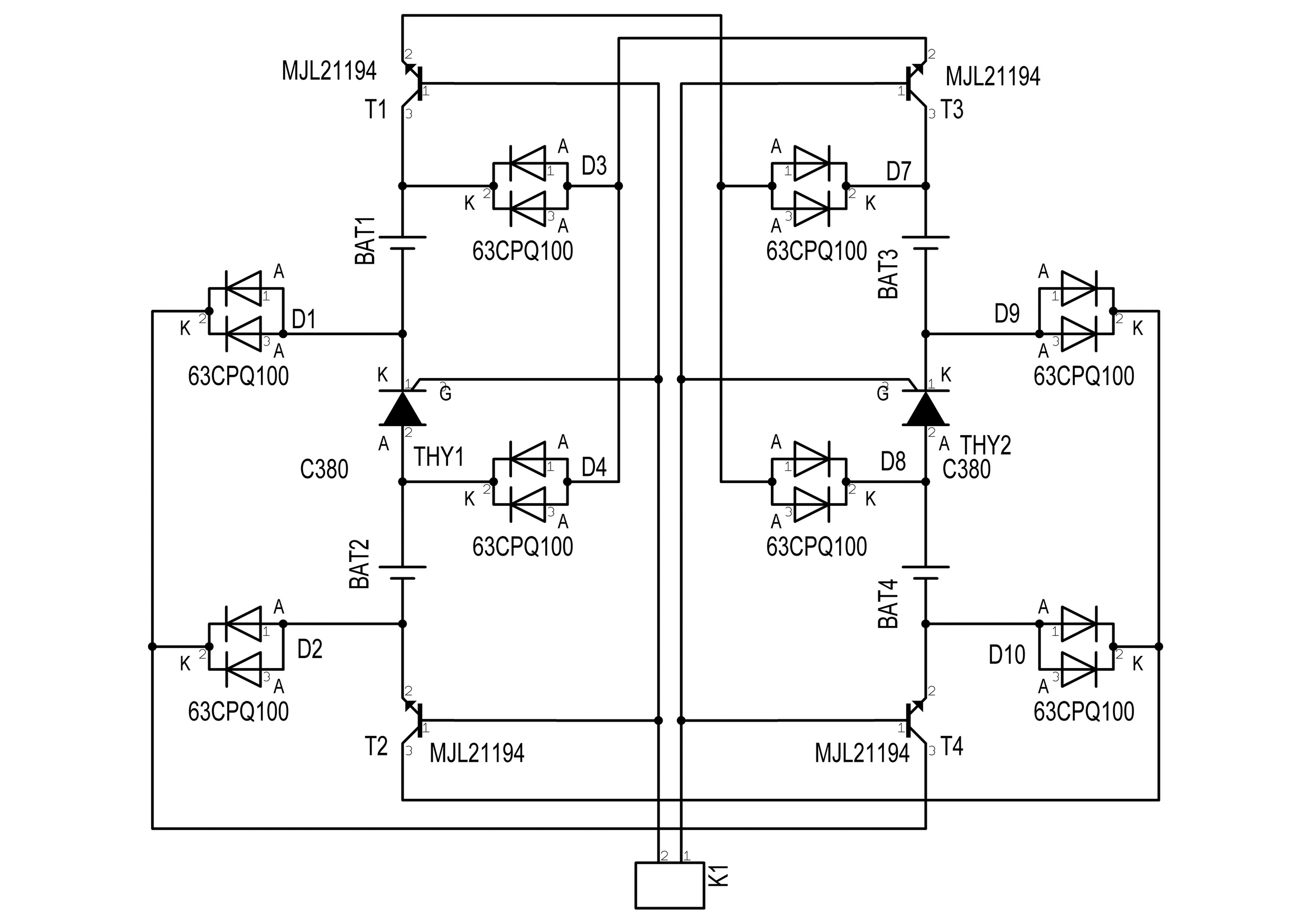

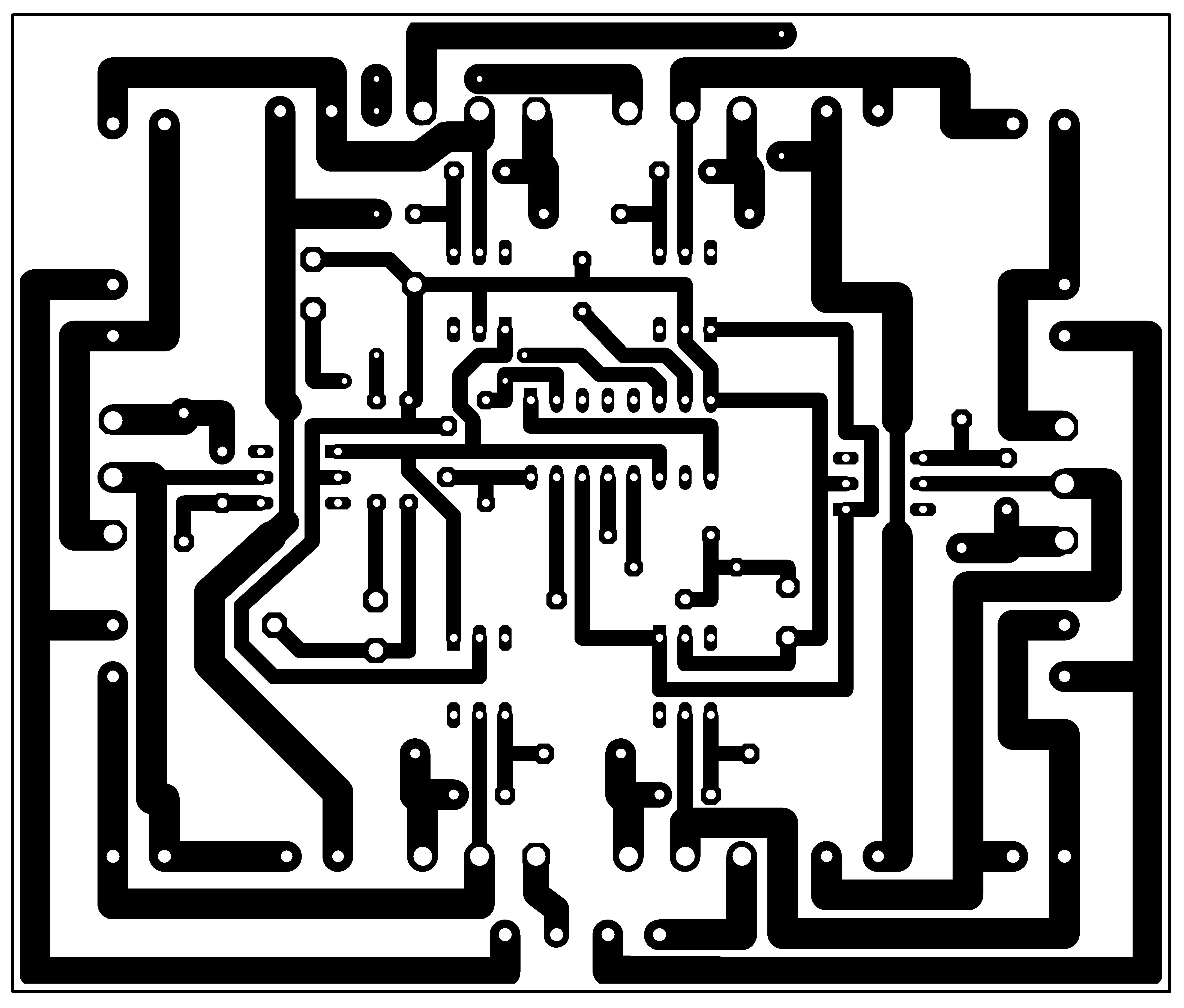

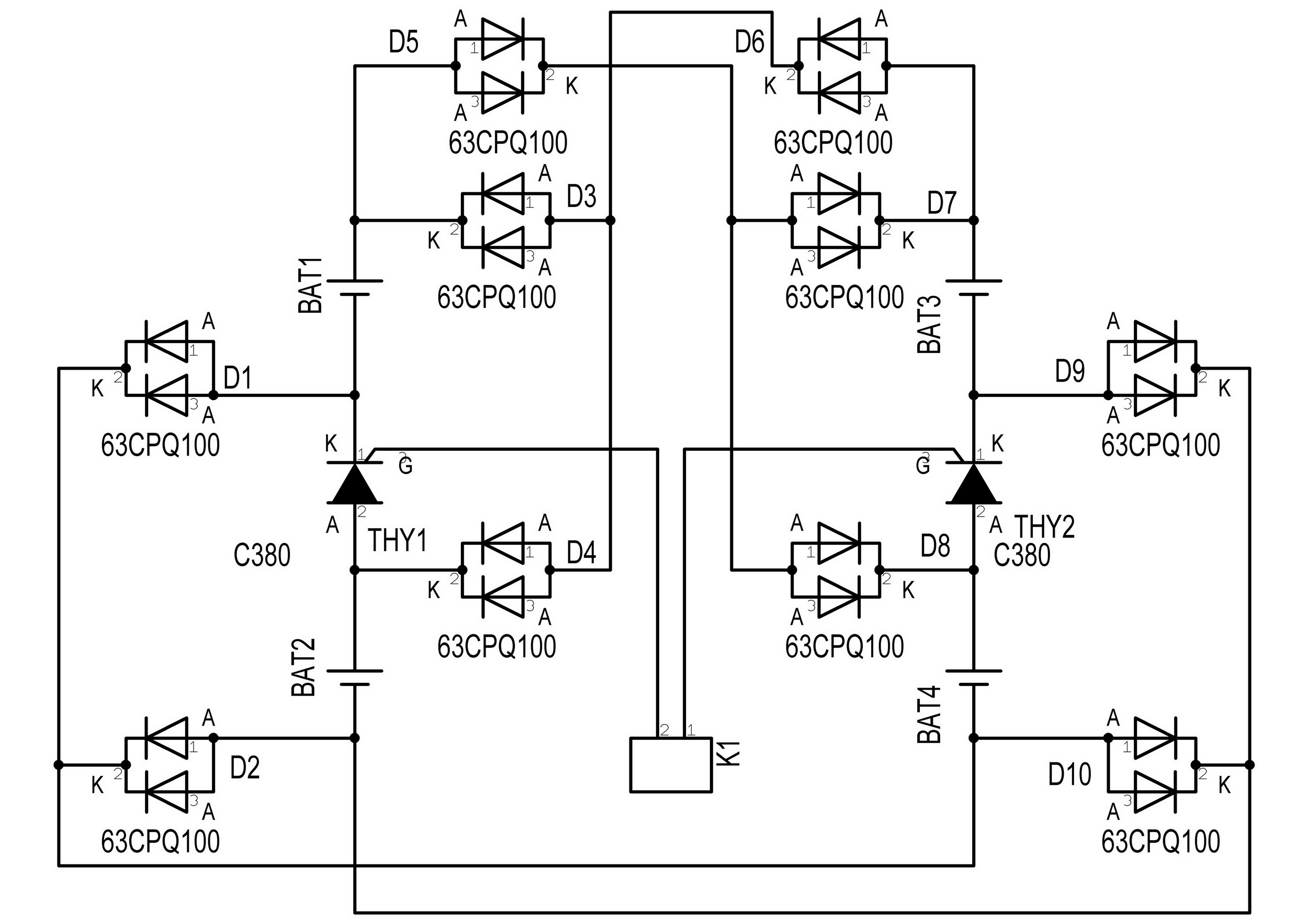

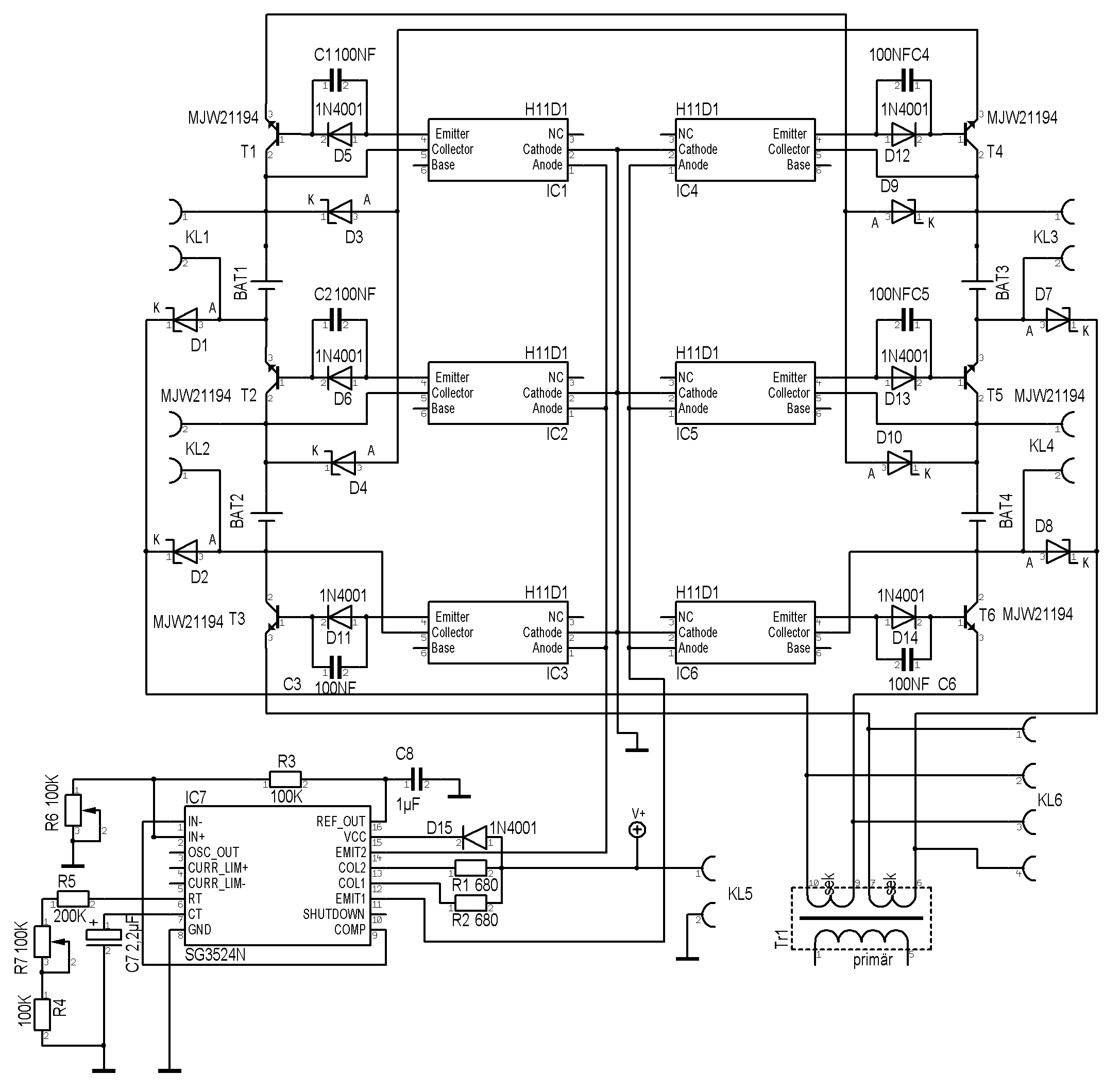

Hi folks.
Here's what I'm going to try (when my picaxe arrives).
Any comments or test results will be highly appreciated.
Forget about the load.
The main purpose of ANY TS build is to charge a decent bank of batteries and run your house with it.
So, enough with this childs-play. Tiny bulbs and toys and God knows what else.
You can have all the loads you need AFTER you charge your battery bank. Right?
Valentin
