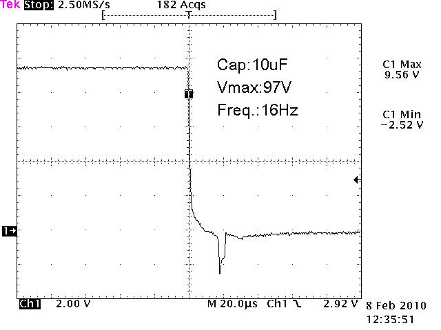

                    • Potential Switch
                      @Leroy
                      Attached scopeshots are captured form inverted potential switch on FEG.
                      Thesewave forms looks like JB's drawing for the Negistor,
                      but I don't think these are right.
                      JANG
                      • Originally posted by JANGYD View Post
                        @Leroy
                        JANG
                        @JANG,
                        Thank you for the pictures.
                        It seems like you are missing the positive going spike in the waveforms. It may have been previous to the downward movement however. My scope probes (maybe the scope) are messed up, and the voltage measurements are not right (it will only cost me $500.00 to replace them...don't have the cash for that), but I can see the waveforms. I do have on the TS, an upward movement, followed by a downward movement to the negative side (below 0) which is at least 1 1/2 times (more like 2 times) the positive going movement, then back up a little, then it stays there for a short time, then back to the positive side. I'm pretty sure this is the correct waveform but all bets may be off due to the equipment. I may have to just bite the bullet and try to find the cash to buy the probes. The upward spike should happen a little before that downward movement, but the downward spike looks about right.
                        What does it mean? What is the correct way to utilize it? Does that downward movement mean that current is flowing backward through the transistor when no bias is present (opto triggered control and the opto is "off", so the base is floating at this moment)? I'm still trying to figure it all out, so maybe we can all work together to get this. Nobody else chimed in about how brilliant they are and how they all have it figured out, so I guess I'm in good company...in the dark!
                        In the dark,
                        Leroy
                        ****EDIT P.S. Picture 1 and 3 look the most right to me. You said FEG book...what are you doing when you capture these pictures?****
                        • Originally posted by ldissing View Post
                          @JANG,
                          You are correct, Leroy, that's one of reason why I'm not right.
                          There was no upward movement on my circuit.
                          I always think why?
                          Do you think(know) why upward movement shoot?
                          Is it possible to get that waveshot with only one switch?
                          Can you test it with only one transistor-making other 2TRs short on E-C.
                          That's the second reason why I am not right.
                          There was some reverse current when the votalge went negative.
                          There should be no current when it goes negative.
                          But I don't know why the upward movement happen.
                          Can you show me the result if it happens with just one swithch working.
                          JANG
                            I always think why?
                            If you are capturing the scope shots while dumping a single capacitor, I would not expect to see the upward movement. If you had two capacitors in parallel, (like the scalar charger) or two batteries in parallel and switching them into a series configuration, I'd expect to see the upward movement first, because you are putting the devices in series when you trigger the semiconductor. The upward movement is when the semiconductor device is turned "on" and potential is moving from collector to emitter through the device. (The positive of the lower cap/battery is more positive in potential than negative of the upper cap/battery.) The difference in potential between the capacitors (or batteries) is causing a move in potential across the device as the positive (lower) and negative (upper) are brought together, i.e. bringing the negative of the upper cap/battery above the lower cap/battery positive.
                            You do not have this (I think) with a single capacitor discharge, it is just straight down from the current level if I am correct on what you are doing.
                            Charges (I did not say current) always flow from a more positive to a more negative potential, so I'd expect it to flow "backward" through the device after the "connection" is made from the lower positive potential to the upper negative potential. Once the device is switched "on", you now have two objects (caps or batteries) in series and the only way for this to look to the device is that the upper negative is more positive than lower positive. So I guess in reality, it must "go negative" and allow charges to flow in the opposite direction or the device would just "shut itself off" and you'd lose the "series" connection on the batteries and/or capacitors.
                            I think I've finally "got it", at least I hope I have.
                            I only have two transistors on each side right now, one to do the series switching and one to go across on the top. I am looking over the series transistor.
                            I believe, based on JBs two transistor TS, (with more diodes) that that is the only device that goes "negative", because of the switching of a more positive collector to a more negative emitter. And, it is not doing it when there is "no" signal on the transistor. The device went negative even when there was a signal applied to the base which is different than what Naudin was saying, i.e. that there is not a signal attached to the base of the transistor. Naudin stuff was running in 2nd emitter breakdown, JBs is just running backward...."normally".
                            Leroy
                            P.S. I've got some more testing to do....
                            *EDIT* The going negative is the reason, you can actually see a potential of the two batteries in series when the transistor is switched on. Normally there would be a big drop over that transistor, which would mean that only 12 + 12 - 4V (tranny drop) = 20 volts is possible on the series side, but I've seen the entire thing plus a little on occasion...When it goes negative, you get the entire thing and maybe a little more depending on how the switching is done which should not "normally" be possible. Maybe the trick is that when it goes negative, to the max point and then starts to come back up, you need to shut the transistor off you need to take the signal to the base away.
