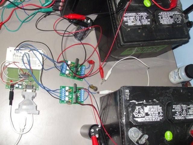

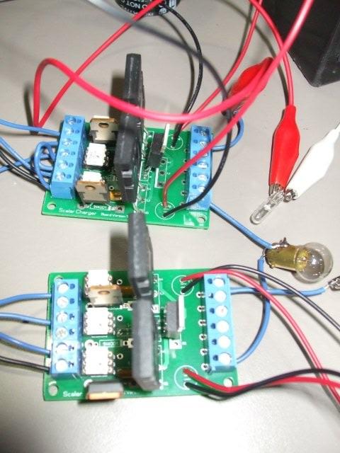

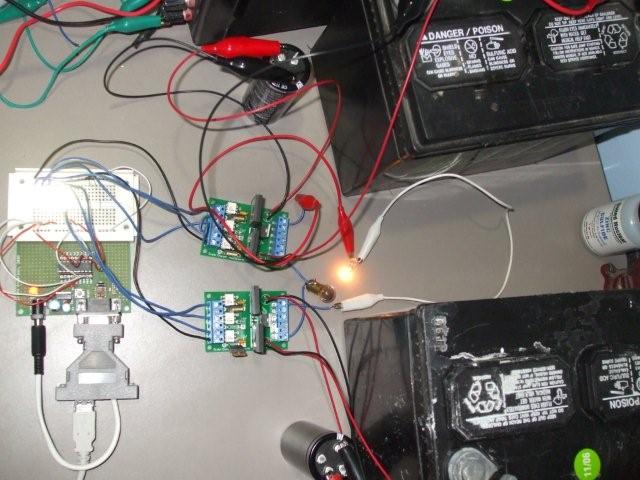

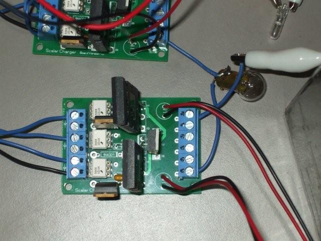

Over the past month, I've been busy with the scalar charger in whatever spare time I can find. I redid my initial circuit to use 470uf and a 10mH inductor. The best I've done was to only lose about .02V/day driving a grain of wheat bulb, but the 4AH gel cell I was using was far from good quality. Without the bulb, it once held its voltage steady for 24 hours while running.
The TS has been described as dual scalar chargers. It wasn't until a couple days ago when that actually sunk in. So I populated a couple more boards and got them hooked up tonight. I only had two flood lead acid batteries charged and ready to go, so I put one in each of the SC boards (in place of one capacitor); the second cap in each board is a 10kuf 100V. (I bought 4 flooded lead acid batteries this weekend, but I'm want to make sure this had a chance of working first.)
Connecting the two SC's together is a #55 bulb (2.9W) between the negative and a 2721 (1.2W) bulb between the positives. The current pulse rate is approximately 200ms on (charge/discharge) and a 500ms delay, so one complete cycle takes about 1.5s. Only the 1.2W bulb actually lights.

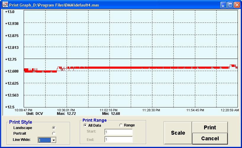

Attached are some pictures and a graph of one of the batteries over the first couple hours. 24hr + resting voltage was 12.70V for battery 1 & 12.53 for battery 2 (no graph). Notice it dropped initially when I used a #53 bulb, but started recovering when I switched to the 1.2W bulb. Current voltage of B1 is 12.71V and B2 is 12.54 with +/- .01V fluctuations, so I'm cautiously optimistic.
