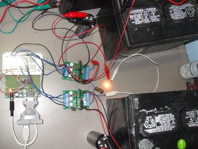

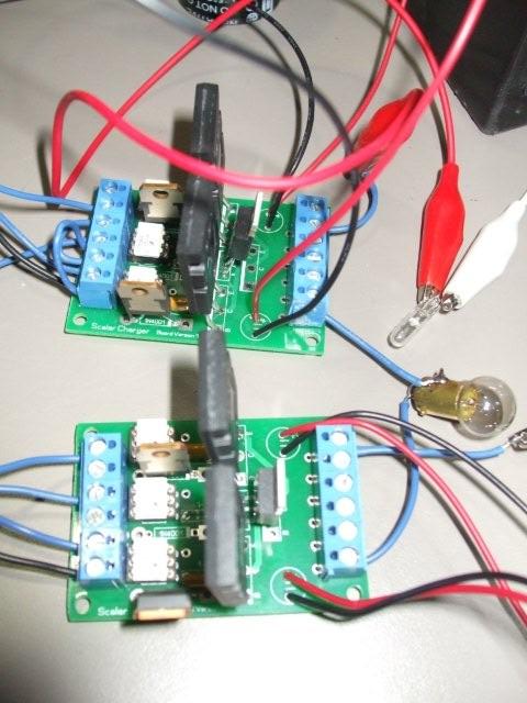

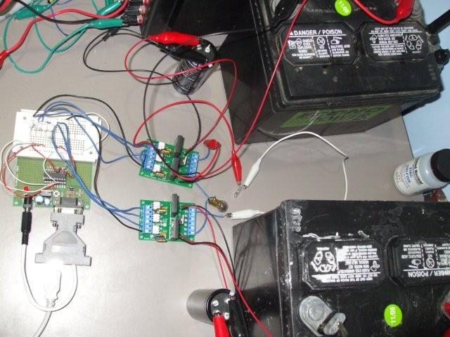

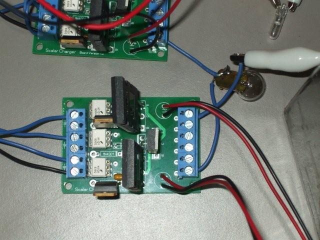

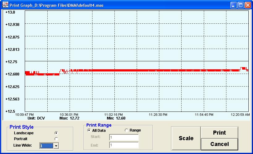

            Over the past month, I've been busy with the scalar charger in whatever spare time I can find. I redid my initial circuit to use 470uf and a 10mH inductor. The best I've done was to only lose about .02V/day driving a grain of wheat bulb, but the 4AH gel cell I was using was far from good quality. Without the bulb, it once held its voltage steady for 24 hours while running.
            The TS has been described as dual scalar chargers. It wasn't until a couple days ago when that actually sunk in. So I populated a couple more boards and got them hooked up tonight. I only had two flood lead acid batteries charged and ready to go, so I put one in each of the SC boards (in place of one capacitor); the second cap in each board is a 10kuf 100V. (I bought 4 flooded lead acid batteries this weekend, but I'm want to make sure this had a chance of working first.)
            Connecting the two SC's together is a #55 bulb (2.9W) between the negative and a 2721 (1.2W) bulb between the positives. The current pulse rate is approximately 200ms on (charge/discharge) and a 500ms delay, so one complete cycle takes about 1.5s. Only the 1.2W bulb actually lights.
            Attached are some pictures and a graph of one of the batteries over the first couple hours. 24hr + resting voltage was 12.70V for battery 1 & 12.53 for battery 2 (no graph). Notice it dropped initially when I used a #53 bulb, but started recovering when I switched to the 1.2W bulb. Current voltage of B1 is 12.71V and B2 is 12.54 with +/- .01V fluctuations, so I'm cautiously optimistic.
            Erik

                      • So Bits
                        @Bit's,
                        My little system has been working like that for a long time, but no charging, although, it takes a long while for it to discharge the batteries as I'd expect.
                        So, the why? Why did you use PNPs, and why do you think you need them? Looked like a 1Hz timing to me, but it is hard to tell. You also utilized some different signals from the controller for the optos driving the PNPs, which I assume are not firing identically with the serial transistors. Again, why and what kind of timing are you utilizing here?
                        I hooked a cap up on just one side, to see what the voltage was across the negative diodes side to the negative of the 24V batteries and it is about 4.3 volts? Seems kind of low. I only have one transistor, but an extra diode, design is exactly the way JB drew his 2 transistor only setup. Of course, 4.3/1.5 ohms =~ 2.86 amps, which is on target for 3 amps through the system.
                        Hope you get some charging out of it too, time will tell on that though and I wish you the best of luck.
                        Leroy

                          Remember me saying (in ref too the Mueller report) that the timing of the tranny's looked like they were firing in somewhat of a "Wave" fashion? The reason for the choice of PNP on the top legs is to introduce a slight delay. The PNP is already closed and we must bias it to open it. So while the coding is such to command Q1 to "Close" and Q9 to "Open" (again with a slight delay) this kind of gives the "snap" were looking for. You may want to table the math for now, (as I had to) it will get you in the ballpark, but things are not too normal with what is happening with this.
                          Hope this helps.
                          Bit's
