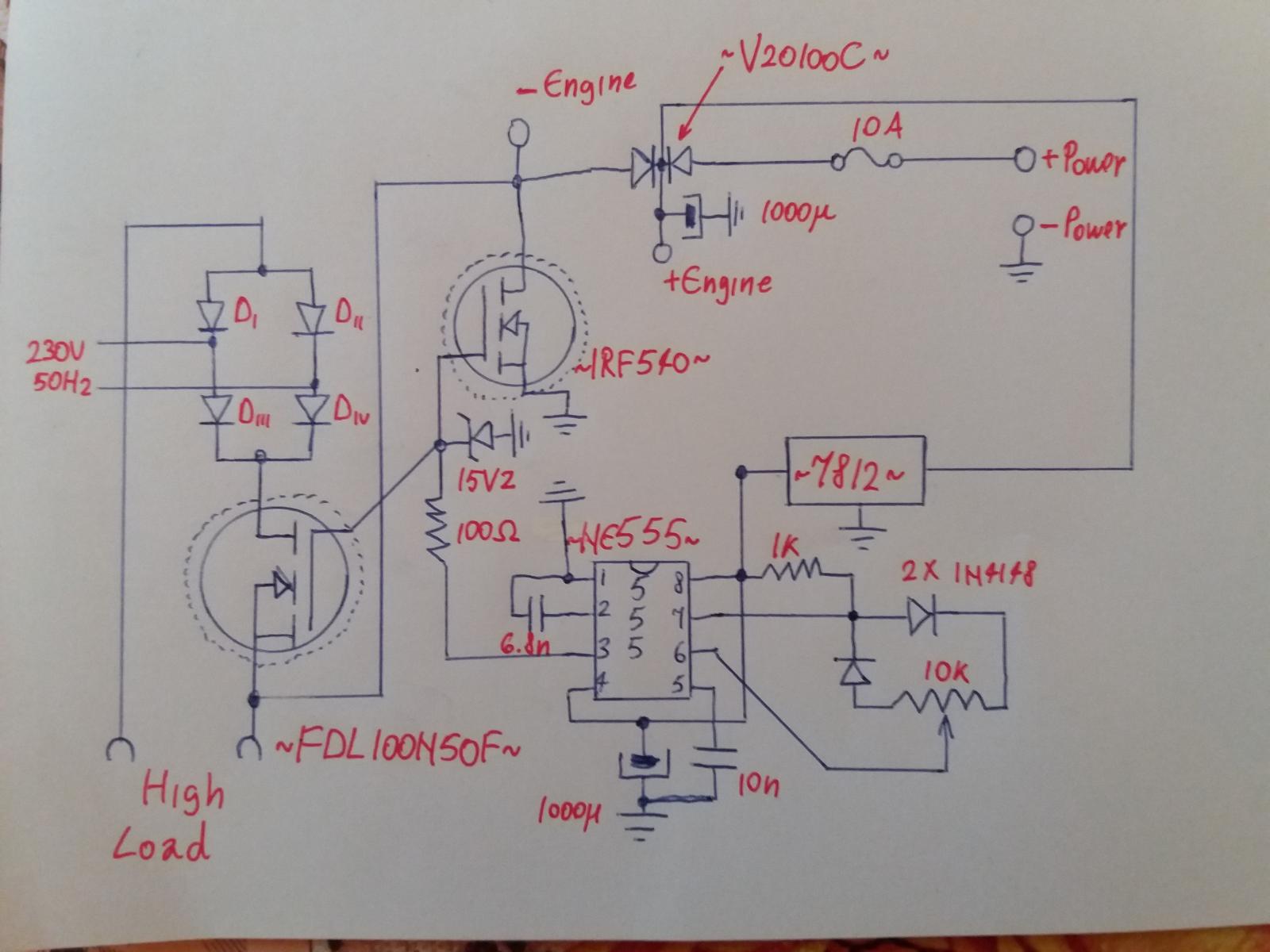

@SPACE Yes, indeed there are a lot of contradictions on this subject, whether triacs can be paralleled or not. I know not what to say....
Your idea on the PWM sounds really nice especially because of the fact that such reactors (dry and wet HHO reactors) the ones that forcefully produce Hydroxyl gas are best supplied from a PWM assembly so they won't get too hot over time. Say, i wonder if instead of a big IGBT i use two or three MOSFET's like FDL100N50F. I have an obsession with this transistor and i want to put it to work.
I was asking the ''electrical engineers'' from stackexchange site whatever... of a method to achieve reduction in the mains voltage to 100V and at the same time to let a current of 36A pass. Simply a power supply that doesn't use a transformer. They didn't even understood what i was asking for, they put me on hold until i ''clarify'' or ''correct'' my formulation. Unfortunately not many are like Dr.Dollard...... That's a real engineer.
I know the principle of reducing the mains voltage, is by reducing both the positive and negative portions of the sine wave. What i want to know is if and how exactly i can use tyristors to achieve that? Tyristors come in all shapes and current ratings and they are much better that triacs in high current applications. I wonder how i can connect them to get the current i need. Probably like this?
But then how do i open them, do i use an ordinary triac circuit with diac?
So many unknowns i have.............
