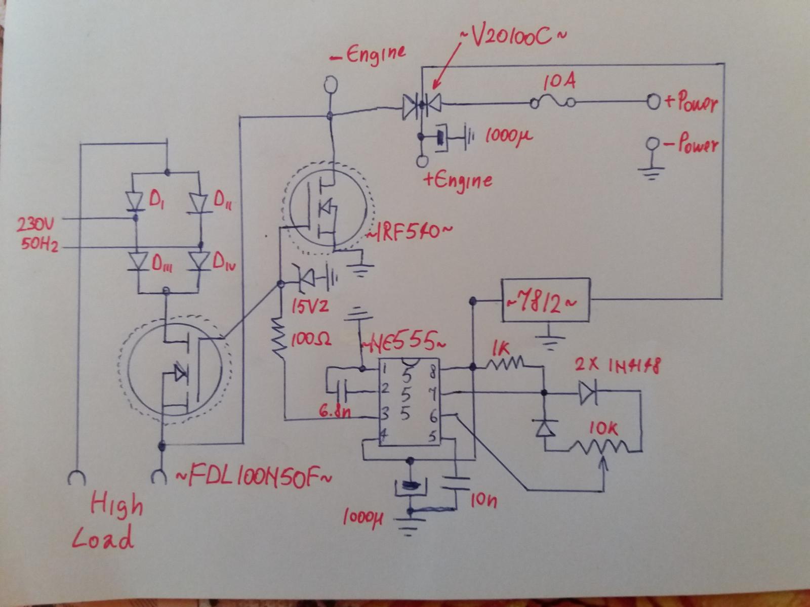

              I used a simple PWM circuit and the FDL100N50F MOSFET and it works like a charm. This circuit is a match made in heaven although heaven doesn't exist, it can be right here on Earth
              I connected a 600W load to it and the transistor doesn't even heat up. What warms up a bit is the bridge rectifier.
              The control part is a simple oscillator from a cheap chinese PWM that arrived today.
              It is very interesting how the power element doesn't heat up since it was burdened by a considerable load.
              Now what i have left is to work on the magnetic amplifier to be able to control the current.
              I was ''theorizing'' about some switch mode power supplies that i would build and to connect them in series to get 100V..... when i don't even know in what circumstances those damn things can be connected in series and parallel...
              One thing i have to add though, the potentiometer has to be of higher power rating, say 1-2W otherwise it may arc inside and heat up a bit.
              Duty cycle 10%-100%
              The bridge rectifier must have a heat sink and be designed for 50A or more depending on the load (it can even be less than 50A).

                as long as your rise and fall time are fast enough, your power transistor on a PWM circuit is going to be small, so not much heat there.
                as far as controlling a PWM circuit,
                it is called pulse width modulation for a reason,
                you change the pulse width to change the output...
                this is usually the input of the PWM circuit.
                not sure what you are talking about with a magnetic amplifier changing the output.

                  I have corrected the schematic diagram. Now it is well
                  The magnetic amp i will use to control the current at the output
