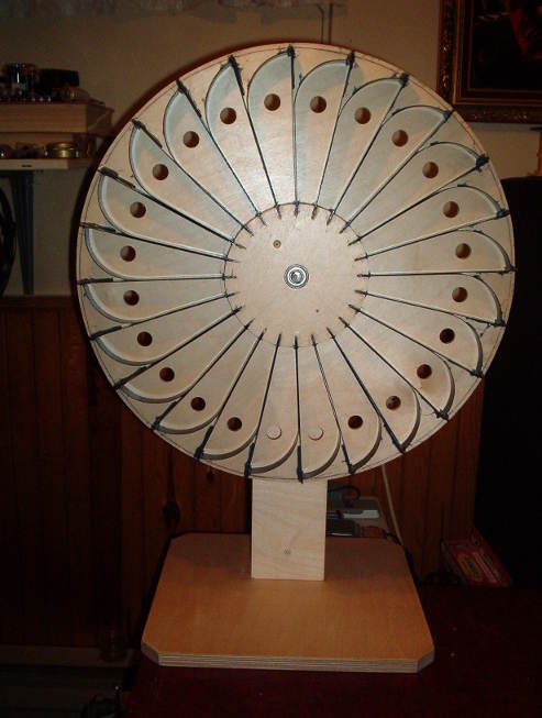

      Hi everyone,
      Today I made the stand for the gravity wheel and assembled the unit for a quick check on how it would look. I still have to clean up the RTV, cut the front smoked Plexiglas and glue it on. Then I have to balance the disk and throw in the marbles for testing before ordering the steel ball bearings.
      As always, a few pictures of the unit assembled. it does look nice standing on my work table.
      Take care,
      Michel

              Preliminary tests.
              Hi Stealth,
              I did preliminary tests on the wheel after balancing it. I needed 10 small office nylon covered paper clips to get a near perfect balance.
              I then placed one nylon covered paper clip at the 0 degree mark and the wheel moved 30 degrees down, so to the 330 degree mark in the forth quadrant.
              I placed 2 nylon paper clips at the 0 degree mark and the wheel drop to pass bottom to about the 232.5 degree mark in the third quadrant, so a move of 127.5 degrees. The wheel then came back to set at the 270 degree mark after a few swings.
              I did wash out the grease from the 2 ball bearings and re lubed with SAE 10 light oil. The drag is pretty low, I did not have PTFE lube in stock.
              Pretty good results so far. I will do more tests when the front facing is applied and the wheel unit gets its final balancing but I expect similar results.
              Take care,
              Michel
              P.S.: The paper clips are 1 1/8" X 1/4". The wheel is divided in 24 section of 15 degrees each, it easy to see how many degrees it moves.
              http://www.youtube.com/watch?v=jeYscnFpEyA

                Last update before the final testing.
                Hi everyone,
                The gravity wheel is all done. The front smoked Plexiglas is on, glued with silicone RTV and it was balanced with the same stuff, it just needed two globs about the size of my small finger tip.
                I also found my box of marbles but apparently the grand children had fun with them and there was only 22 left and I need 24. BUMMER I'll have to go get some at the dollar store tomorrow.
                That was a fun project. The next one will be my version of the windbelt.
                Cheers!
                Take care,
                Michel

                  Conclusion of the Gravity wheel project.
                  Hi everyone,
                  Today I bought a bag of glass marbles and did many tests;
                  One marble every three slots.
                  One marble every two slots.
                  One marble in each slot.
                  Two marbles in each slot.
                  Three marbles in each slots.
                  Conclusion: it does not work.
