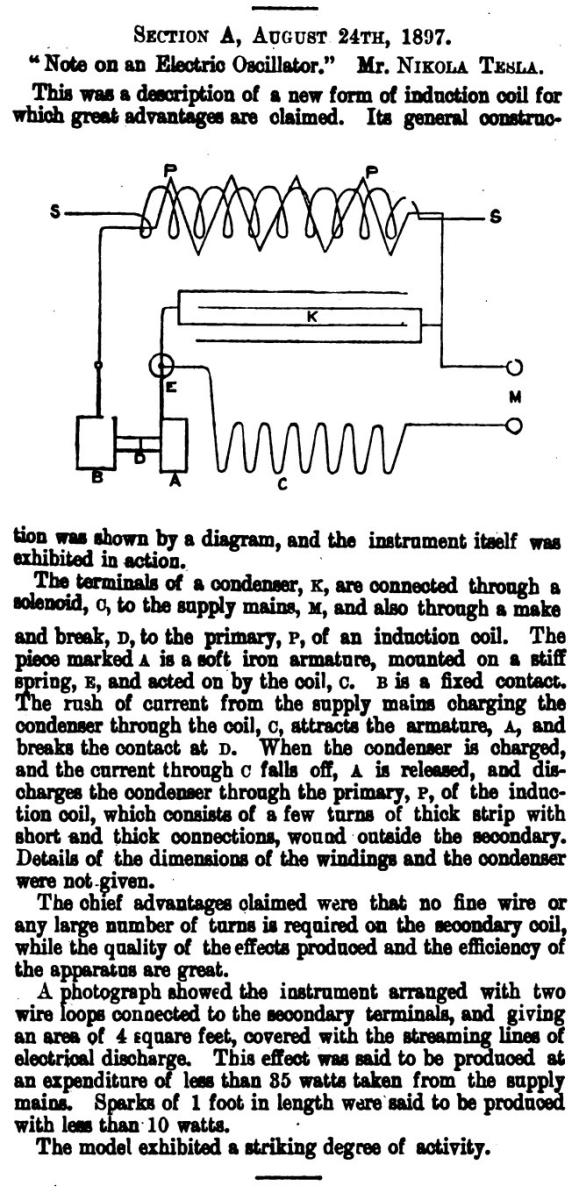

Ok got it no problem! I don't have a strong engineering background so forgive me in advance or feel free to ignore XD! I'll start things off by asking what would Eric consider the absolute minimum amount of wattage one could use and still observe "Tesla-like" effects (I can't really think of the correct terminology at the moment)? I ask of this because I came across an article, in which somehow 1-foot sparks were obtained with less than 10W. Also what are Eric's thoughts an electrostatic generator/Induction coil going into the input of a Tesla coil set up instead of an AC step-up transformer? Is the input source interchangeable so long as it provides the high voltage needed or does the AC step-up transformer provide a specific advantage over an electrostatic generator or induction coil of similar output?

The amount of power is immaterial since coil operation is linear. Small power small effects; large power big effects. Length of an arc is generally related to voltage, and not necessarily output power in terms of Watts. Electrostatic generator is not applicable: the source of power must be in the radio frequency range.Originally posted by Sescher View PostOk got it no problem! I don't have a strong engineering background so forgive me in advance or feel free to ignore XD! I'll start things off by asking what would Eric consider the absolute minimum amount of wattage one could use and still observe "Tesla-like" effects (I can't really think of the correct terminology at the moment)? I ask of this because I came across an article, in which somehow 1-foot sparks were obtained with less than 10W. Also what are Eric's thoughts an electrostatic generator/Induction coil going into the input of a Tesla coil set up instead of an AC step-up transformer? Is the input source interchangeable so long as it provides the high voltage needed or does the AC step-up transformer provide a specific advantage over an electrostatic generator or induction coil of similar output?SUPPORT ERIC DOLLARD'S WORK AT EPD LABORATORIES, INC.
