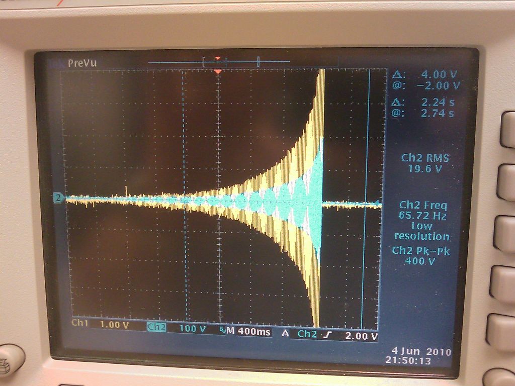

                    • It works!!
                      Well, we ran it. It works.
                      There are some caveats, however. As predicted by the formula, the output current increases geometrically, which means the magnetic field is also increasing geometrically. Unfortunately, the high magnetic field causes our motor shaft to pull in, which causes our 030" gap to close loudly...metal on metal. We do see the motor current increase a bit due to the lateral shaft force, but we don't think that the increase in motor load matches the amount of output. Unfortunately, until we can get a better mechanical arrangement, it will be impossible to verify that there isn't an equivalent load on the motor. Of course, once the core pieces start hitting each other, the motor draws far more current still...and it gets loud.
                      That said, it works exactly as predicted. We managed to get it stable at about 100VAC for a while. At 100VAC, we measured about 1.8 watts of dissipation across a 1.5 ohm resistor, as well as about another watt in one of our caps that was breaking down. That cap was a mistake, but it worked out well...it became the non-linear load that kept it all stable. This agreed very well with the predicted 2.5 to 3 watts of excess power at 1 amp.
                      Note the scopeshot: This is the output going critical. I pulled the wire to shut it down. Note that it hit 381vpp before I pulled the plug. Obviously it showed no signs of slowing down, and the current was well above 1 amp at that point, but we had no way of measuring.
                      I think this is the real deal...
                      • Did a bit more playing. Put about 0.5 ohms inline and put a scope on it. Peaked out at well over 8 amps and 400vac....yikes. Blue trace is across inductor. Yellow trace is across resistor.
                        Now we gotta figure out how to regulate it.
