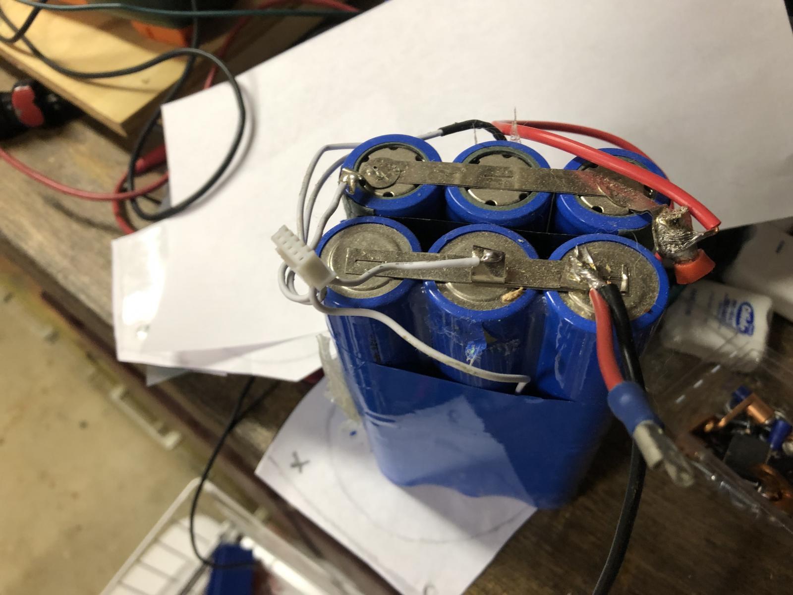

        That may be typical, but it is not what I have. As you can see from the photo, six cells, not four, so the voltages per cell are different from your specs.

            Here is the photo. This picture is when I first took it apart and realized I would have to remove all the electronics to use it in the single battery circuit I showed here. Right now it is broken down even further. But at least this shows it is made up of six cells as I said. Got it on Amazon. Don’t believe anything there indicated six cells.

              Hi Turion,
              Thanks for posting the photo.
              What you have is a 12 cell battery in a 3p4s configuration, meaning 3 cells in parallel and 4 of those wired in series. Likely consisting of standard 26650 cells, 26mm dia x 65mm long. Functionally behaving as a 4 in series battery but at 3 times the capacity of a single cell.
              You can clearly see, in the photo, bus bars spot welded to the ends of 3 cells on the positive putting those 3 cells in parallel and similarly, on the negative.

                  I was considering each “stack” as a cell. Once again terminology is an issue. When I took that battery all apart, I ended up with two in series plus two in series, connected in parallel for 6+ volts.
                  Then four in series plus four in series connected in parallel for 12+ volts. Yes, there are twelve cells. You want to say four groups of three. I put them together differently so I could get the potential I wanted. I left them in six stacks of two, connected in series. Since there were six stacks, I assumed each cell was two volts because I didn’t pay much attention to the way they were connected. After all, I was tearing them apart. Now that I actually measure them I see the voltage is a little over 3 volts per cell.

                    The 12 volt, 7.2 amp high discharge rate hour LiFePO4 (Lithium Iron Phosphate) battery is designed to be a drop in replacement for standard sealed lead acid batteries in UPS, alarm, and other similar applications
                    Quote from Amazon link provided by Turion. And the electronics packaged in the battery is the BMS, Battery Management System. You'd be hard pressed to find a commercial product with Lithium battery which doesn't have a BMS or sometimes called a PCM, from cell phones to power tools to electric cars. The BMS protects the Lithium cells from overcharge and undercharge and also equalizes the cells, as well as often communicating with the charger, other batteries or the operating system. BMSs can range from basic (somewhat simple) to very complex.
