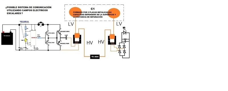

I'm confused. Each flyback has two terminals : HV and low voltage. Mostly low voltage of secondary is joined with primary and can be grounded.
Here there is an old flyback without joined terminals.Yet still IMHO output secondary has one HV terminal and one lower voltage or ground terminal.
Which one is used as single wire transmission line ? HV or ground terminal ???
Look at my comments on picture.
LOOK AT THIS DRAWING HERE IS THE INFORMATION YOU NEED, IF YOU UNDERSTAND THIS DRAWING AND THE MATERIALIZED EXACTLY, YOU WILL GET RESULTS IDENTICAL TO MINE:

mira que te encuentro por todos los lados tio... pareces jesucristo,Originally posted by antigraviticsystems1 View PostLOOK AT THIS DRAWING HERE IS THE INFORMATION YOU NEED, IF YOU UNDERSTAND THIS DRAWING AND THE MATERIALIZED EXACTLY, YOU WILL GET RESULTS IDENTICAL TO MINE:
