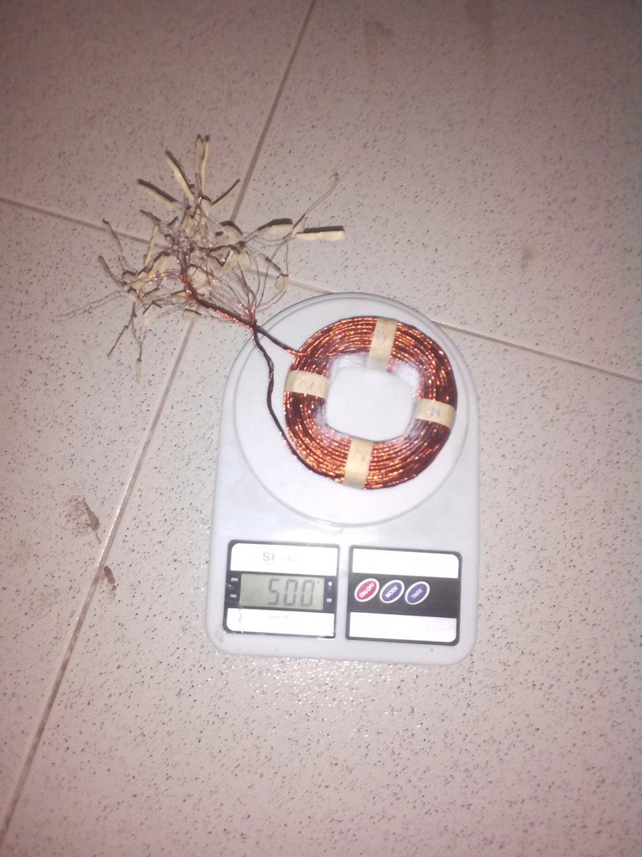

                      You are a blessing to me from God.
                      I am not gonna apply MOSFET in my design as I plan to go Extremely big with Voltage minimum of 500Vdc so I am gonna apply mechanical commutator which I will make myself.
                      Also my wires gonna be Serially connected Multifillar wire of 100 strands so as to gain Powerful Flux without adding any more wire to the coil. This in turn will boost the torque and negate any residual Lenz effect.
                      I plan to use 10 individual Tesla-Idea-Wound-Serially Connected Electromagnets.
                      And my plan is to wind Secondaries under each or the primary electromagnet in the same direction each of the Electromagnet is wound. That is: CWp CCWs and so on and so forth.
                      But the Secondaries will be paired at 45° and connected in parallel to negate Lenz which means they will be in Bucking mode every time they got energised which will be continuous as they receive amplified power from the Neo Mags and Overlay Electromagnets.
                      May I know your take on this Sky?
