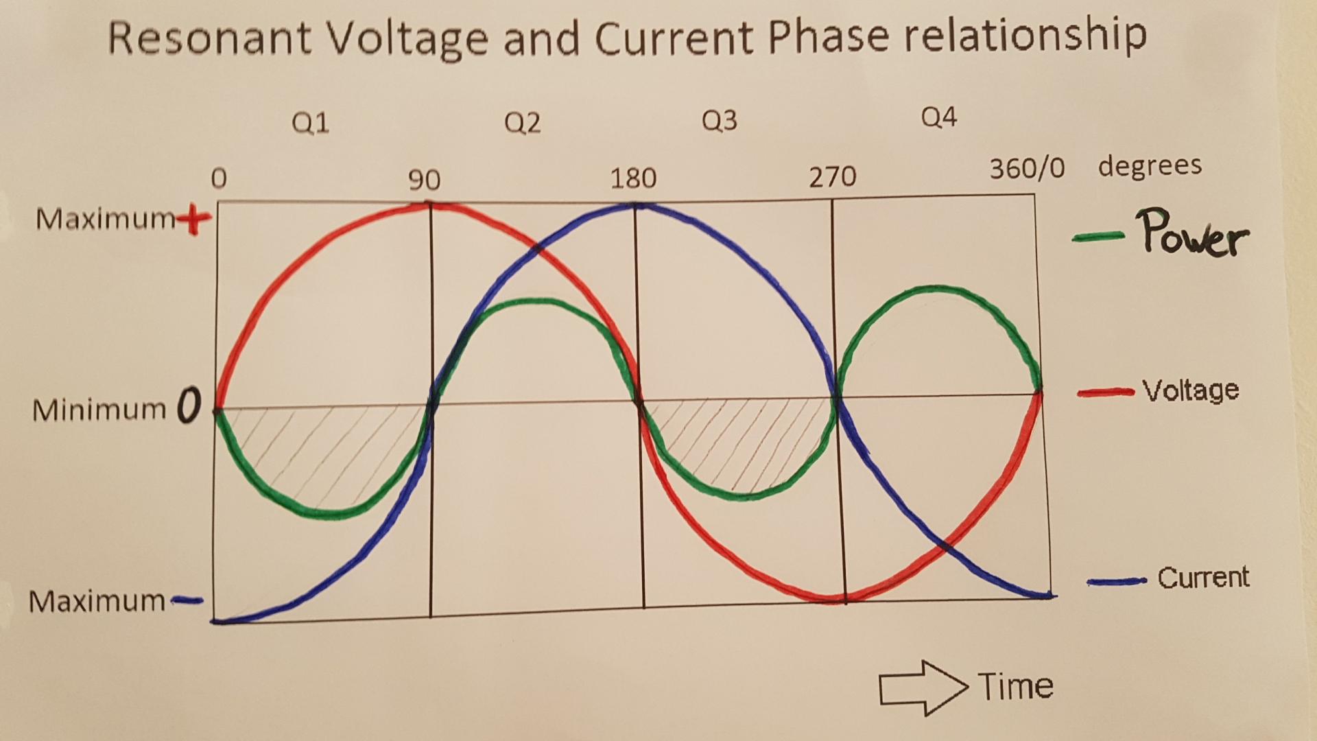

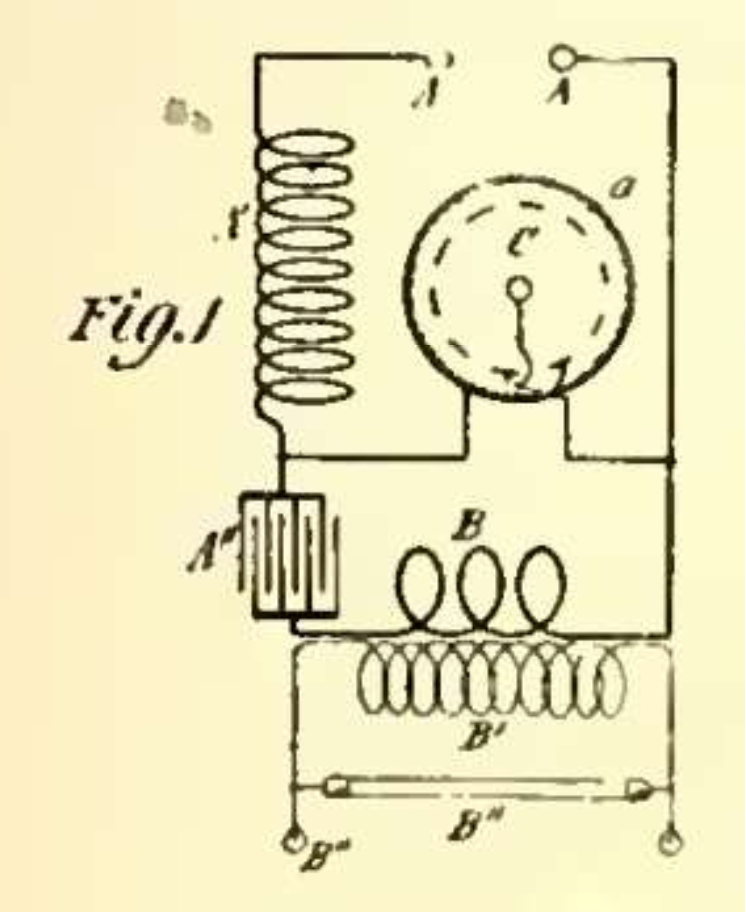

I made 2 new videos, they show the series mosfets switching together, using a basic Radiant power circuit (2019 april),
This makes it possible to create high voltage (3500V) impulses, from coil discharges, using 2 1200V SiC mosfets in series switched.
This video explains the idea of mosfet switching, and the Tesla oscillator article is explained:
https://youtu.be/w9I88HYY_Z4
This new video of me, shows the series mosfets switching:
https://youtu.be/7vfDjN2hkBg
Multiple mosfets could be used, but the bottle neck would probably be the isolated gate driver (which could be a optocoupler with glass fiber)
, and the isolated dc dc converter (which could be a battery).
I tried using 1700V mosfets, but their pinout was wrong.
The c3m1200V mosfets are on order but should be available later this year.
Many think Tesla only used capacitor discharge current impulses, by making use of quenched sparkgaps,
.but he used coil discharges in his later years of research, to create voltage impulses
My idea still is to use a dual primary setup, one for dielectric induction (use the pancake coils as capacitor plates), the other for magnetic induction
