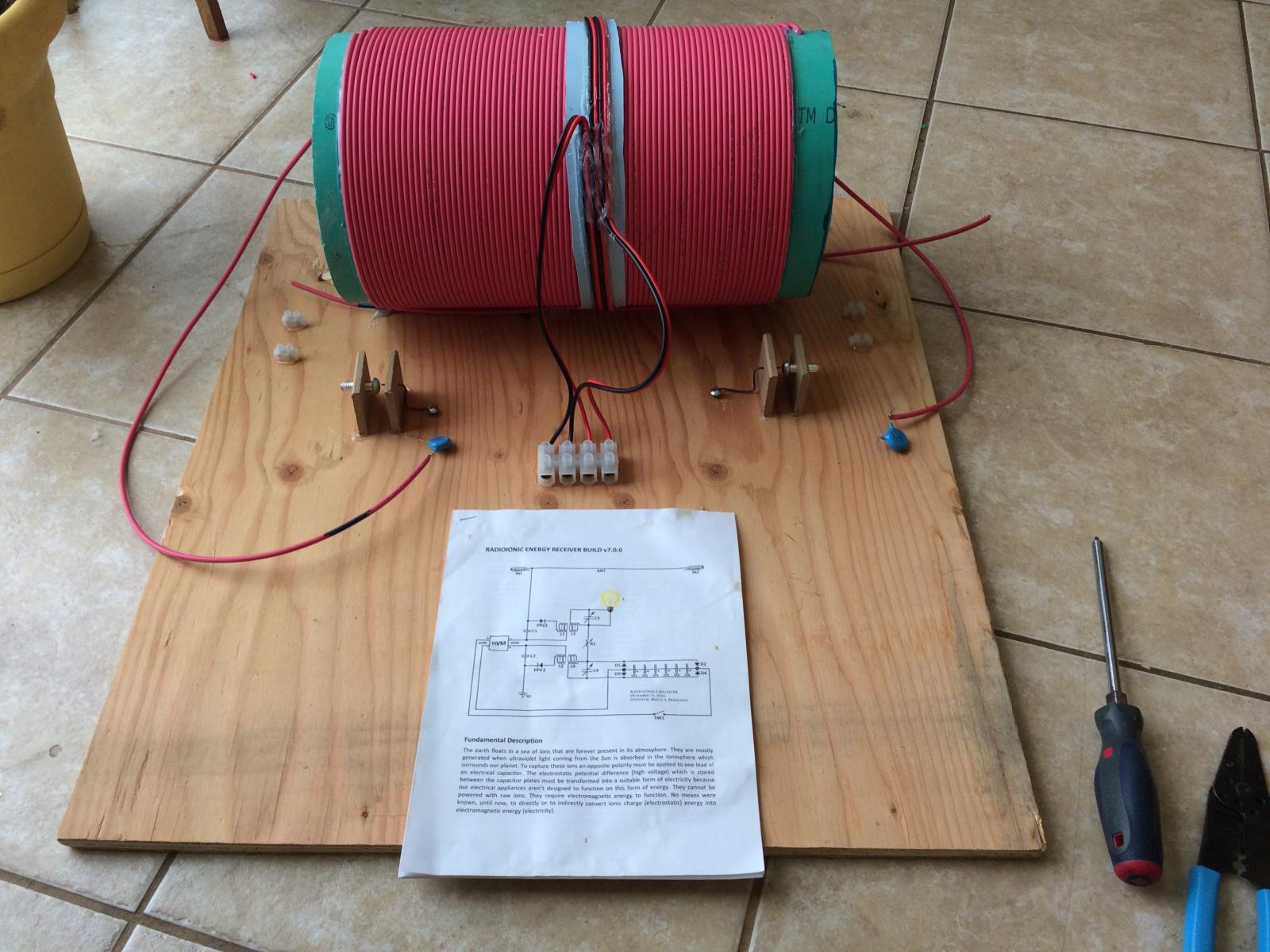

            Here is my setup for today (the only time I have ).
            May continue tomorrow!

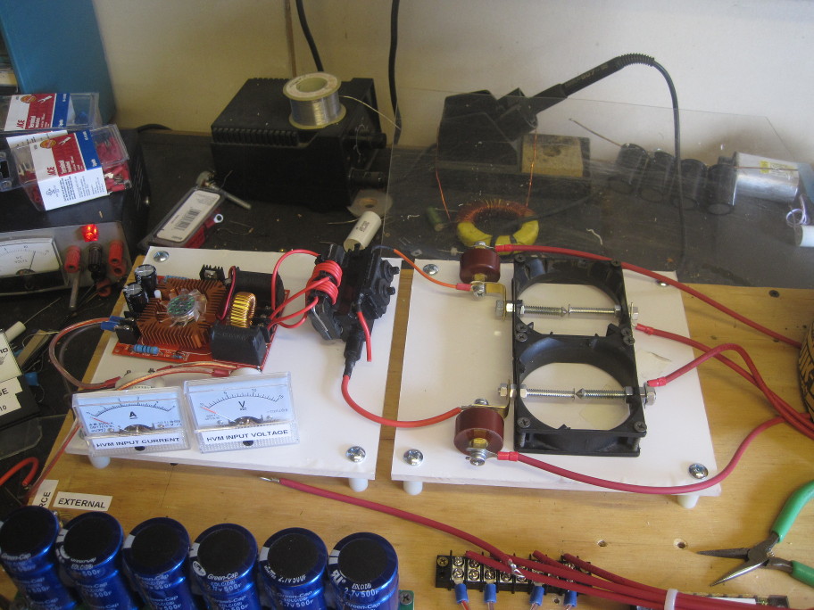

                  • OK, tightening up the build quality of the HV section. Wood anywhere close to HV is not good. Standoff distances are going to have to be close to 2 inches to reach higher voltages. I made the HVM on a separate baseplate from the PPV/cap section, so I can drop-in a replacement HVM section with the PVM12 and multiplier stacks when it's ready. I also took the brass brackets to the belt sander and rounded off the corners to reduce corona.

                          • Tonight's progress: more-or-less completion of the HV side (need to figure out a good way to mount the meters), and measuring the actual antenna current. Measured 0.25 mA using the analog meter while driving device with ZVS at 24V input. This represents ~7W of power at 26KV. No light on the bulbs with either one bulb or two, but of course one secondary is now charging the cap bank so this represents a load. Cap bank pre-charged to 12V and no looping tested. Spark is a brilliant pure white.
