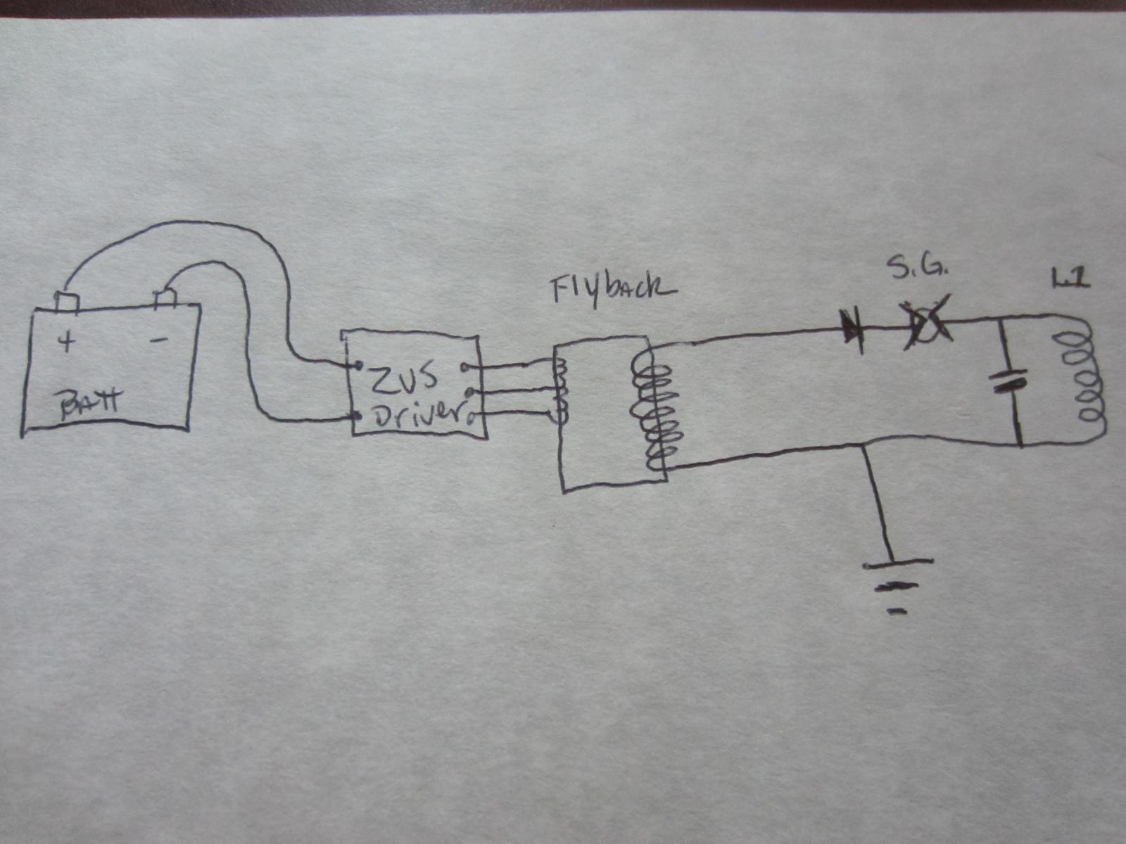

something like this?
Yes, exactly like that. It will zap the coil/cap combo at the output frequency of the ZVS driver and the spark should be a continuous hiss. This is the configuration shown on many of Don's schematics and Bruce's original diagram.
In the new modified diagram from Bruce, all that the ZVS does is charge up a cap to a high constant voltage. The small current from the antenna charges the C2/L1 cap/coil combo in the configuration more like the standard Tesla coil primary, where the spark gap goes between the HV supply and ground, and the coil and cap are in series. If you did it this way using the ZVS it might spark 100 times a second and the spark will sound like rapid-fire pulses and can be quite loud. The oscillation frequency of the coil and cap combo is the same in either case and is determined by the capacitance and inductance, not the driver frequency.
