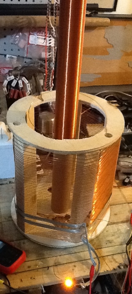

                        hi all just up late winding coils, here is my work so far on the Magnifying Transmitter, looking good, 7.4vRms input, 8.85v across bulb (burns out LEDs, thought it broke lol then replaced LED and was BRIGHT again, whew)
                        anyway, dont worry, this is for driving real bulbs (halogens, incandescents) but im just tuning right now. there are MANY particulars, but i tuned it for max brightness, then connected the Resonator / "extra coil" and massively intensified
                        Power is taken from the base of the secondary and ground
                        THE ~Magnifier~ (Tesla called it "extra coil" )
                        "excessive EMF's can be obtained from use of Extra coils, not inductively coupled to the primary..."
                        "practically Any EMF could be obtained, limits so far remote, easily 1000ft streamers..."
                        "although a high pressure can be reached with 2 coils, it will never be as much as when xtra coils are employed because L2 will always act on L1, not so with XtraCoil"
                        N.Tesla 1899

                                but by ferrite rods maybe the LMD analog? those rods are .5" dia 3" long, from Digikey i believe, comes in a huge box of like 100
                                coils were wound end to end, 30 gauge mag wire, then measured to find lowest inductance, and removed turns to the rest to make them all 2.133mH and all same direction (the coils will find their own polarities in the process)
                                As for the Smith build, in case of plain ole good info..
                                -copper tubing for primary (but it was an old coil, used it cause its dia and turns worked out, but was CCW) shouldve been same direction as secondaries (to my knowledge)
                                -B&W coil cut in half (didnt have the 4turn/inch so bought the 6 turn/inch)
                                better inductance anyway
                                -avoid large capacitances, as Don used, based on projects Nemesis, and Zeus popular Tesla coils a huge amount of info was documented and referenced to Colorado Springs notes as guidance, along with conventional transmission line theory being possible. the intention was to construct ~the Magnifier~ but not to follow anyone elses notions on wireless power or vindication of Tesla even...
                                ....it was for unravelling the operation of the Magnifier, and MAX terminal output
                                PERIOD
                                ..."when larger primary inductances are used, more tolerable caps can be used at smaller capacitance, and massive secondary inductances can be brought into play..."
                                i weighed the coils to get an idea of needed primary tubing, then compared the lengths, actually wasnt far off from 1/4, but as discovered from the above, systems can be far out of balance and still work if compensated with small enough capacitance
                                --and that the spark rate is a small fraction of the tuned frequency (not in most people's ability, unless rotary gap) so im just saying go as small L1 capacitance as you can without having to modify your coil too much
                                -dont buy huge output storage caps like Don did, yes they fill right up but just tuning caps where needed and maybe diodes just before load, to act as kind of a resonance barrier in a way, or your tuning will tend to change with different loads. you generally dont want anything robbing power, and untill the big output caps fill up, a load cant be placed onto them ive found.
                                gotta run, hope that helps
