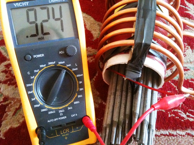

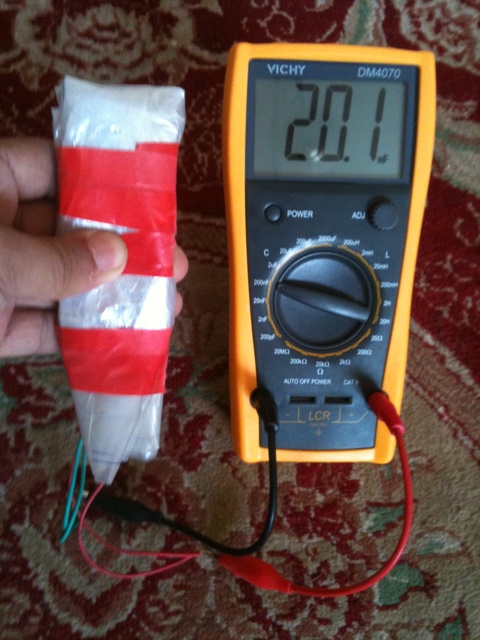

                            u can use lcr meter to check capacity of home made caps. needs some hit and trial methods to get 200 nf
                            hi all
                            i get 924 uH for L1 coil by using welding iron rods and 20.1 nF homemade for 36.93kHz
                            thanks to all

                              hi all
                              thanks to all
                              [ATTACH]11171[/ATTACH]
                              [ATTACH]11172[/ATTACH]
                              Did you test your coil's own self capacitance & factor that in???
                              Well done anyway, looks like a nice little set-up. I suppose I should get off my backside & make a start on mine!
