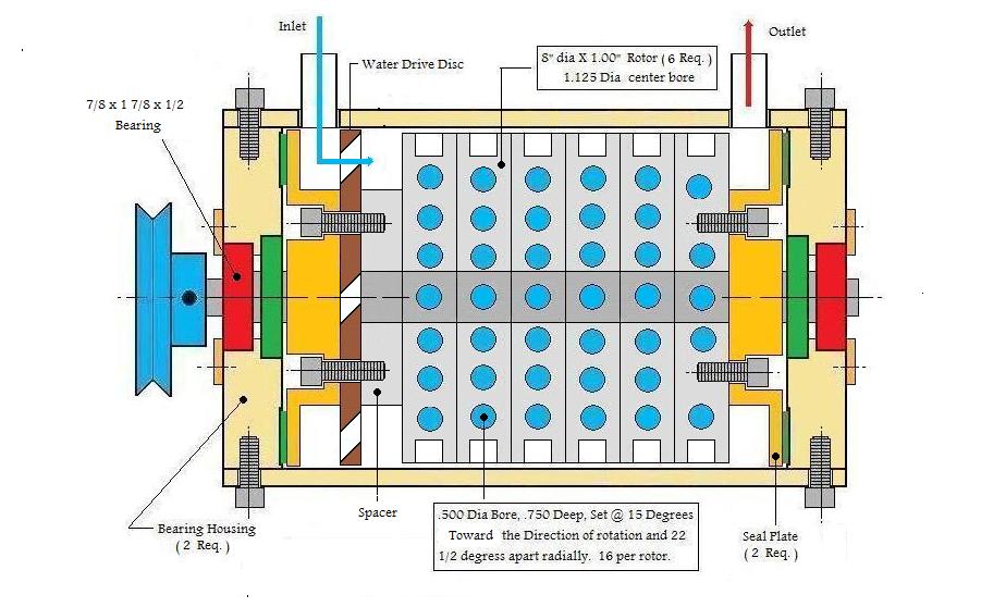

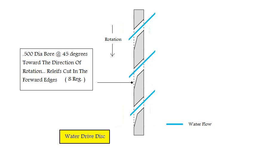

I'm sure by now we've all seen the Griggs "Hydrosonic pump", but has anyone tried to build one or has information on "How" to build a similar pump to heat water. ?? I would like to try a replication. I've done some searches and read
the patent, but nothing specific to the actual build.. Can anyone help??
