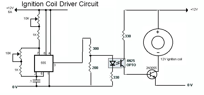

Started with Aromaz's circuit, then tried to hook up a basic 555--> 2n3055--> ignition coil, works for a while but then the 555 pops it clogs, or blows its cookies due to the high voltage.

and under the adive of Aaron, am also going ot try opto-isolating the 555 from the high voltage side.
soooo...... got the opto isolator today so i am ready to go with that, but ive never worked with one before and as all of this is pretty much a learning experience for me, i need help with the circuit, the attachment shows how i "think/hope" it gets wired up..
the opto is a "High Voltage Opto Isolator4N25"
Thanks in advance.
David. D
