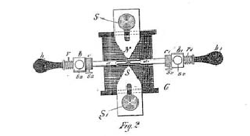

So I have my hv output connected to a hv capacitor, and I've started with a very small spark gap. I get rapid discharges, but they are pretty distinct and I can tell it's not that high of a frequency. I tried putting a fairly strong magnetic field surrounding the spark gap, but it sounds very much the same. I thought maybe the spark gap has to be larger so the discharge is more intense for the for the Lorentz forces to have a stronger action. So I made the gap wider but still I can't really make out any observable difference with the magnetic field vs without.
In the article from Tesla "On Light and Other High Frequency Phenomenon" he clearly states that with the magnetically quenched spark gap, the sound of the discharge is more like a gun shot which he says is because the discharge is formed and broken several times. I guess he means formed and broken several times for what would have been a single discharge.
Has anyone created a nice magnetically quenched spark gap, and noticed a considerable difference compared to the same without the magnetic field? Tesla's assembly seemed pretty nice, especially since he was using an electromagnet which he could vary the intensity to fit his needs.
