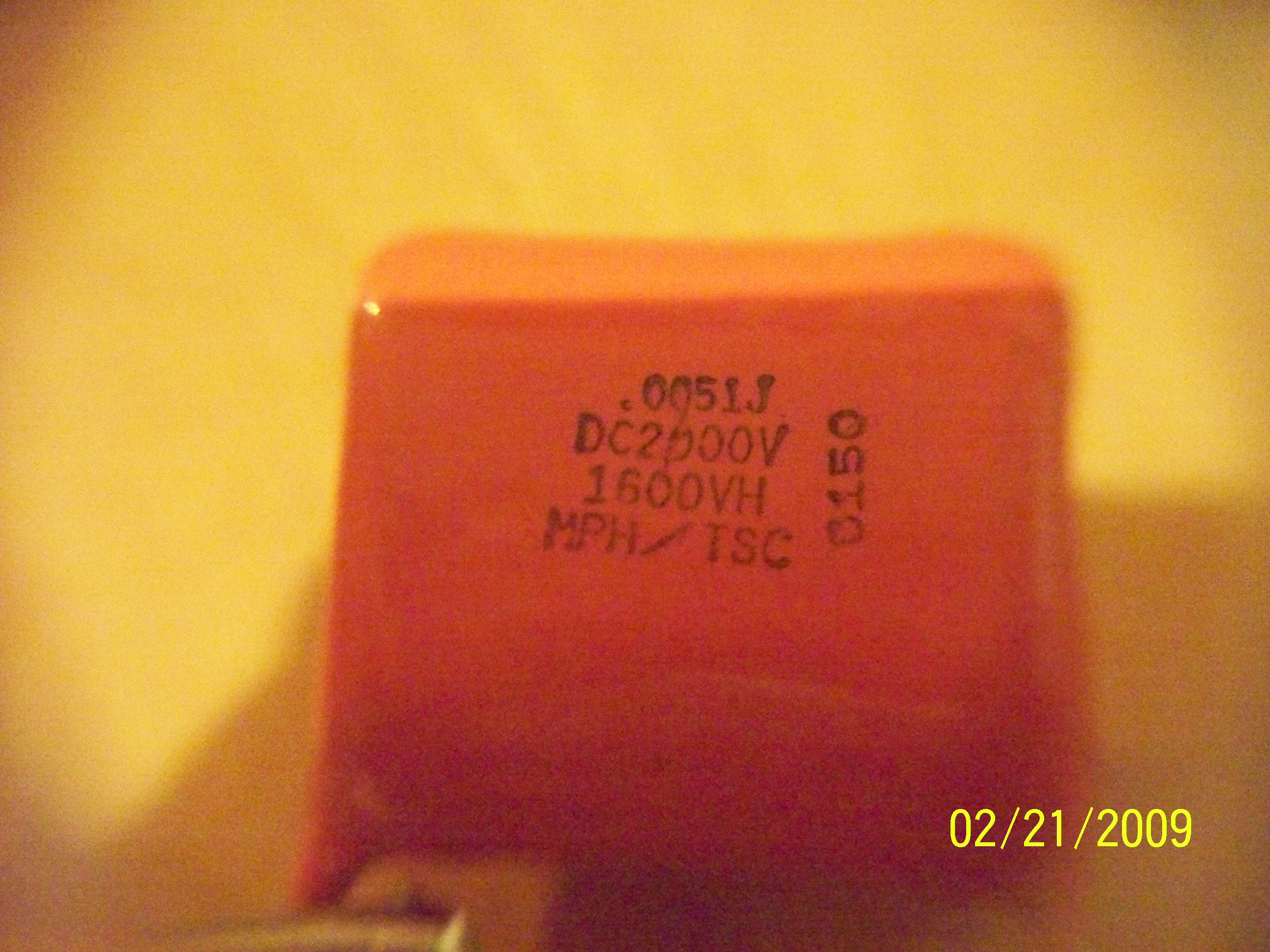

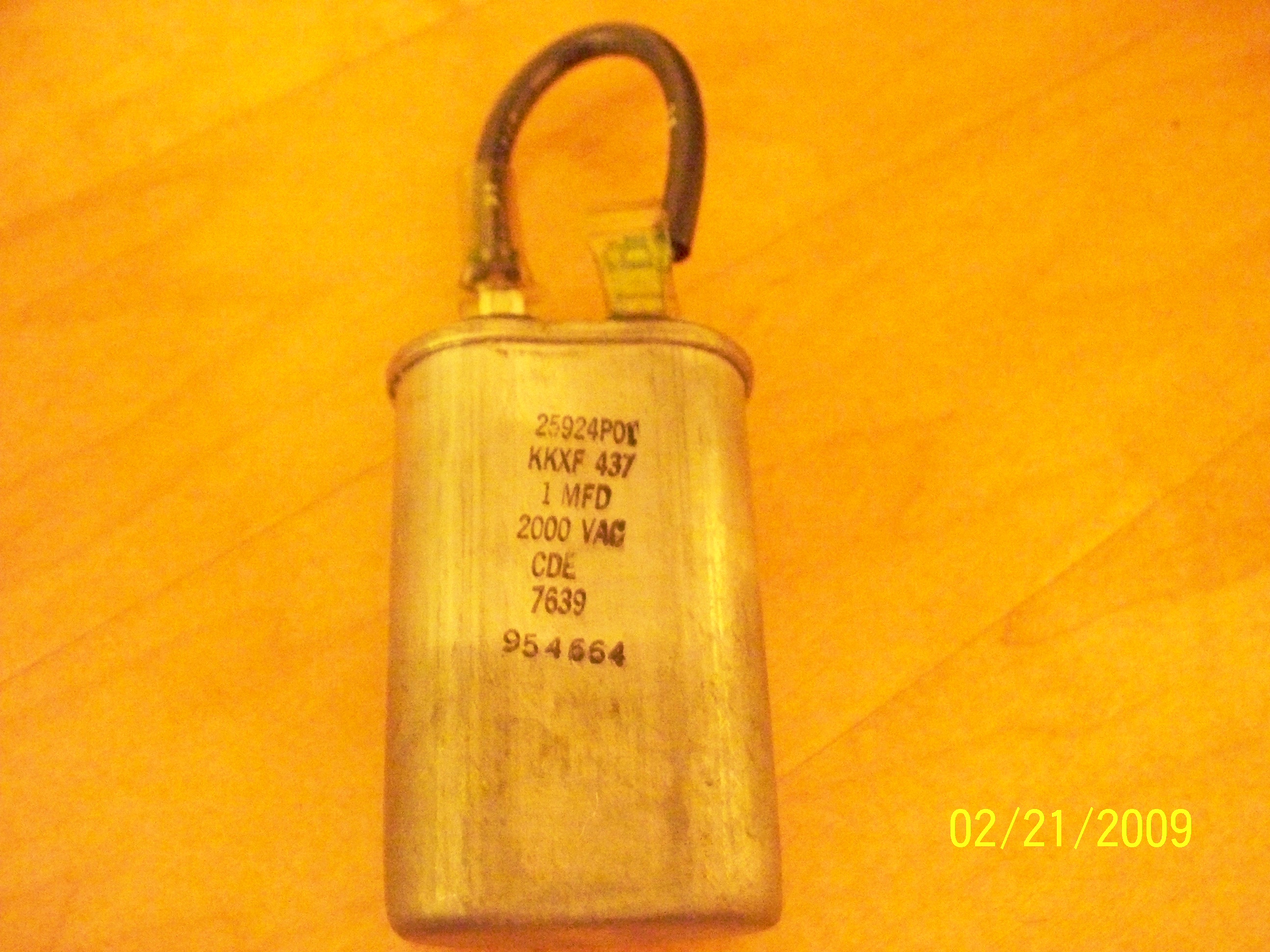

                        The small cap that was tested in the videos is from the CRT logic board 104 pF if I'm reading it correctly.
                        The large cap is from a microwave.
                        I'll post pictures of them...

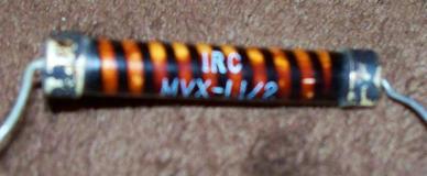

                              Hey I just connected this (see image) to the anode to see what would happen.
                              The spark became continuous (or appeared to be), and was a very soft purple. It also had a really high pitch sound, nearly inaudible.
                              I thought it was an inductor but now I'm not sure. It says lrc, is it an inductor resistor capacitor all in one?
                              The total markings are:
                              lrc
                              MVX-1 1/2
                              6 MEG
                              20% 7636
