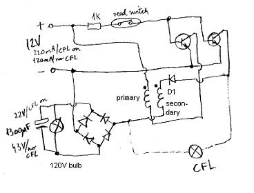

          I tried to make the schematics of your circuit after Lidmotor latest video on your circuit and attached it below. Please tell me if it the same you used in your latest two videos? (not considering his CFL load because he mentioned it was an extra load and you did not use it I know)
          He has not mentioned if he used the two transistors placed next to each other or used only one.
          My other problem if you use both transistors and switch them on and off at the same time by the reed contacts, then how can bemf current flow through the secondary coil (because bemf is created at switch-off but then the second transistor is also off, hence no current can flow through it).

            In your drawing both collectors on the transistors should be together.
            The ones just a slave transistor, you could allso use just one.
            With mine I didnt use a rectifier eather I just ran it to my capacitor.
            Then for negative you can use eather the + or - of your source battery.
            I like to use the negative.
            Then I put a diode in between the battery and capacitor.
