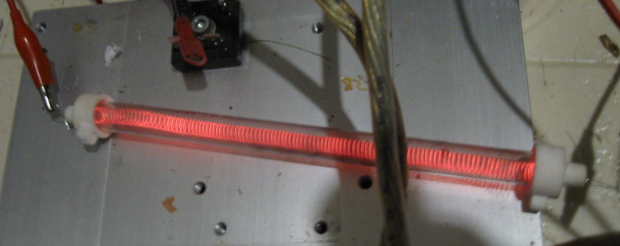

Below is a picture of a 500 watt heating element being driven with 130 watts. It's still just under the 1200*F temp, still operating in the IR band which produces good heat. My current set up will only drive 3 of these.
The reason I'm focused on the IR band is because you can achieve higher BTU output with less energy. The coils are placed inside a quartz tube so the air flowing around them cannot cool the coils allowing them to emit infrared radiation continuously. When the coils are glowing orange they produce a radiant electromagnetic frequency that interacts with a thermally conductive work piece such as copper. This produces eddy currents in the metal absorber - just like inductive heating but at ultra high frequencies. With open air coils you only see the heat produced by the electrical current flowing through them... we want to use the radiant energy produced in the IR band instead of the electric used to produce it.
For those interested, I've included a nichrome chart which shows how much current is needed to produce a certain temp for various size wires. For instance a 12 volt system you might choose the 28 ga wire at 2.8 amps to achieve a 1200*F coil. The wire is 4 ohms per foot so 1 foot of wire would be sufficient, this would require a 33 watt input to achieve a 1200*F temp on the wire.

I did read previously about the added efficiency of the infrared bulbs and i wondered why they used the copper sheeting in some of the heaters I've seen, now i know why.
So is that a homemade bulb you made?
It looks like you coiled nichrome wire and placed it inside a quartz glass tube.
If I'm comprehending what you are saying, by encapsulating it like this, it prevents the transfer of heat to the greater surrounding air and causes the coil to become hotter and glow and emit the proper IR frequencies, to interact efficiently with copper material.

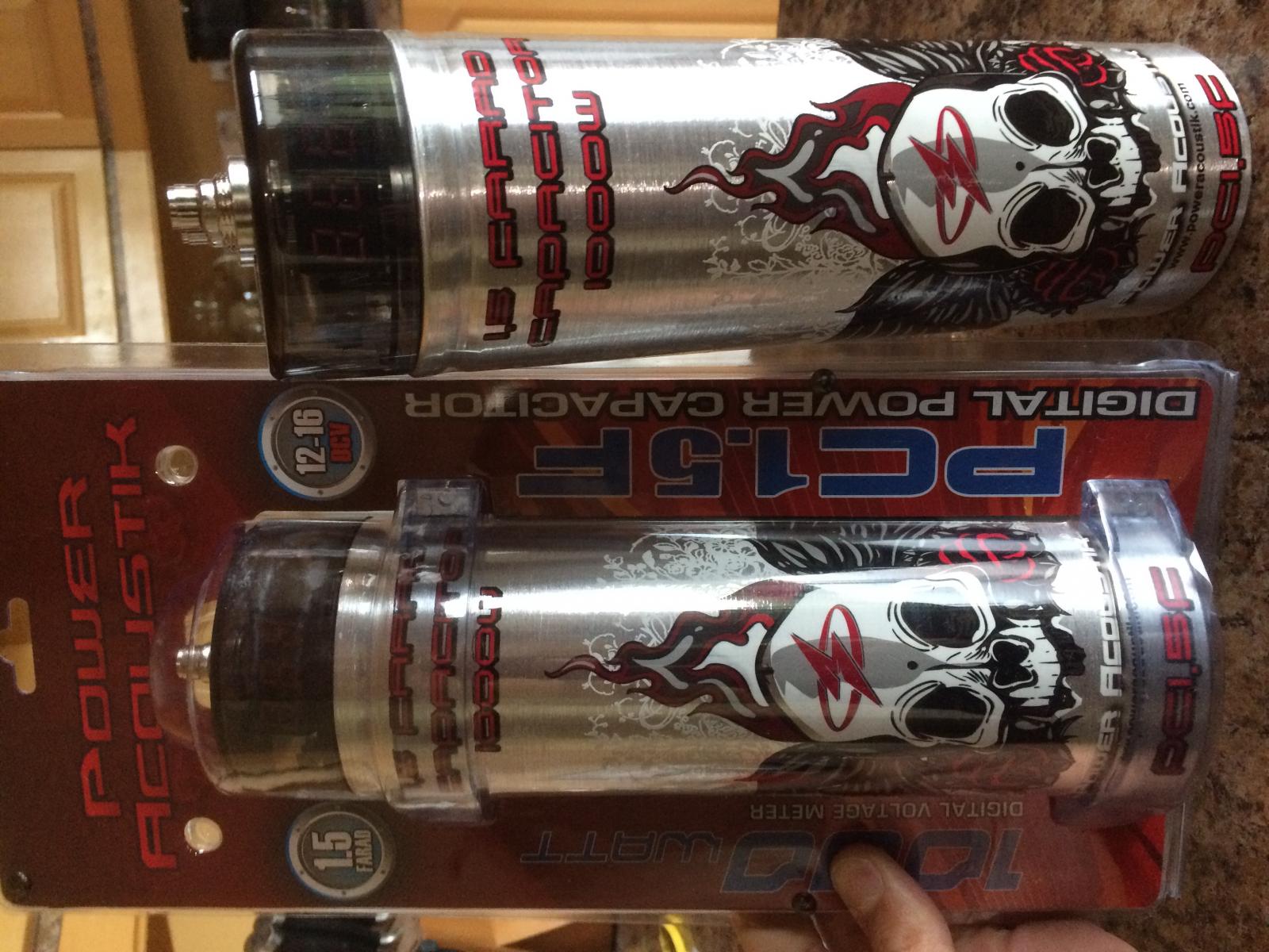

The 2 cap are arrived! Just in time for the weekends.
Thanks for the info about the polarity of the cap vs load. Maybe a new schematic is needed to avoid confusion... if you do that I thank you in advence.
Will let you know about my progress...

Hi wistiti, nice capacitors.
i removed all the circuitry from mine some time ago, though it shouldn't be a problem leaving it on, though it will draw down the energy in the caps some.
Look forward to any results you share wistiti.
Hi dragon, thanks for the compliments.
The next step will probably be a different or bigger load and i can also adjust the switching speed a little.
I'm wondering if the voltage will be high enough and stable enough to power my dc/dc boost converter, it's a 400 watt version.
If the voltage is not high and steady enough for it, there are other lower voltage boost converters i can try.
Just realized, it would need a bridge rectifier, hmm, will think about it.
