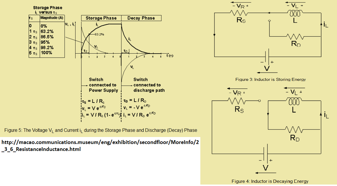

      Inductor
      Hi Allen,
      Your terminology is confusing. "BEMF current"? What is it? A voltage? Or a current? Can't be both.
      The behavior of voltage across the inductor and current through the inductor is well established during the storing of energy (building the magnetic field) and during the decaying of the energy (collapsing magnetic field).
      As you can see, IL (current through the inductor) is in the same direction for both the storage and the decay phase. VL (voltage across the inductor)is opposite polarity for the decay phase.
      Hope that helps,
      {edit of 7/24/2016} I now regret making this post. I never had any contact with Allen before this thread. I was simply trying to help him by providing useful reference material and suggestions. For no good reason Allen became rude and insults me. He says not to bother him with facts because he wants to invent new ways. Allen doesn't know what he's talking about and doesn't want to know. My advice is to avoid him.
      Also many of Allen's statements are incorrect or false. I wouldn't believe anything from him.
