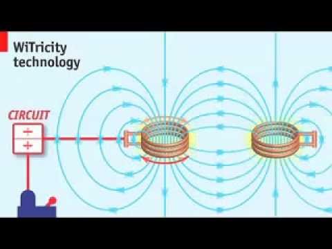

    Hey guys,
    Here's a video from my main interest: https://www.youtube.com/watch?v=HGPZ...ature=youtu.be
    I started with a kit from Rick Friedrich on Resonance Induction that comes with a great book that I consider must reading. Everything in the video I made except the frequency generator/amplifier. It is very simple, but has ramifications that are worthwhile.
    Enjoy,
    Bob

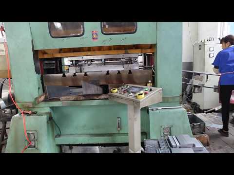

                      Core material
                      #1 GRAIN ORIENTED--3.5% Silicon
                      #2 Non GRAIN ORIENTED -- new processes in the last decade 6.5% Si-steel
                      #3 Ferrite's (many mixtures)
                      Better read thru this.
                      https://www.jfe-steel.co.jp/en/produ...og/f1e-002.pdf
                      What this shows us is the Ferites do not handle large amount of power so looks like Turion is on the right track by pursuing steel with a greater coating. The new processes do exactly that. They keep the steel but have coated it again increasing the overall Si content to 6.5% which is being called a super-core material for the time being.
                      SEE PG 9
                      Non grain oriented okay? Non grain oriented, you got that? Just plain ole steel with more Si. You ask why wasn't this done sooner? Because anything over 3.5% made it so brittle making it almost impossible to manufacture anything with it. The Freq range? Look at the chart near the bottom right, 1000hz and above and can handle lots of KW, not so with ferites. Dave is right, all done by following the experiments. Good job Dave
                      Why magnetic alignment is no longer needed? Donno goes against the grain HUH?
                      It might be possible to take steel wire and coat it with soft silicon/ferrite.
                      https://www.youtube.com/watch?v=XLBUi_N7blk
