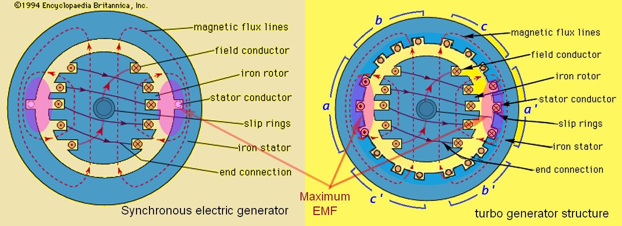

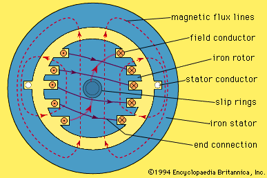

  • By the way, even in the Britannica the principle by which an EMF is induced in the conductor of a synchronous generator with closed magnetic fields is not indicated; there is only a statement of the result.
    Electric generator | Types, Uses & Advantages | Britannica
    Rotor
    elementary synchronous generator

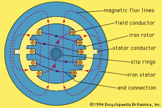

    An elementary synchronous generator is shown in cross section in Figure 2. The central shaft of the rotor is coupled to the mechanical prime mover. The magnetic field is produced by conductors, or coils, wound into slots cut in the surface of the cylindrical iron rotor. This set of coils, connected in series, is thus known as the field winding. The position of the field coils is such that the outwardly directed or radial component of the magnetic field produced in the air gap to the stator is approximately sinusoidally distributed around the periphery of the rotor. In Figure 2, the field density in the air gap is maximum outward at the top, maximum inward at the bottom, and zero at the two sides, approximating a sinusoidal distribution.
    Stator
    The stator of the elementary generator in Figure 2 consists of a cylindrical ring made of iron to provide an easy path for the magnetic flux. In this case, the stator contains only one coil, the two sides being accommodated in slots in the iron and the ends being connected together by curved conductors around the stator periphery. The coil normally consists of a number of turns.
    When the rotor is rotated, a voltage is induced

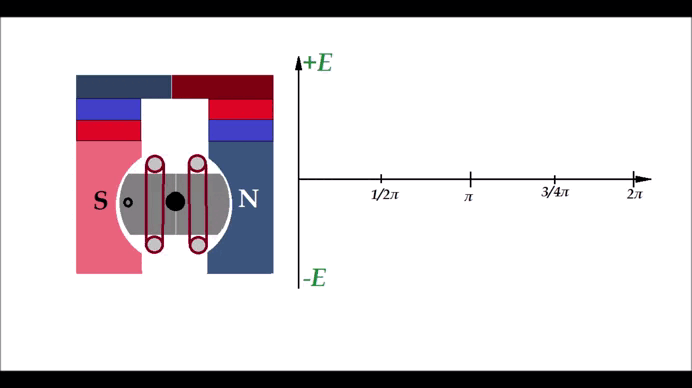

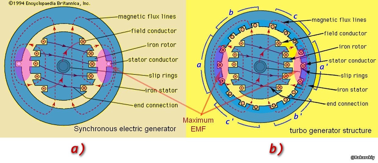

    I made my own drawing which is exactly consistent with the maximum EMF with a three-phase winding and an implicitly polar magnetic rotor.
    Click image for larger version  Name:	480452977_9226741477409199_1244883750594752467_n.jpg?_nc_cat=103&ccb=1-7&_nc_sid=bd9a62&_nc_ohc=4C5fZtzzN8oQ7kNvgH9qPo4&_nc_zt=23&_nc_ht=scontent-iad3-2.xx&_nc_gid=fZ79WcEDj4_MyBqCKKc-aw&oh=00_AYH7Pxe3WIHgknznnljXs5BA-BR_HpXctx Views:	0 Size:	163.2 KB ID:	515823To calculate the maximum EMF in a three-phase generator, you need to use this position. By the way, one of my friends asked his acquaintances in Israel to perform a registration of the maximum EMF depending on the rotor position on very good equipment. Unfortunately, these results were not provided to me for review, although I was the initiator of such a study. They wanted to prove me wrong. I wonder why they refused?
    • Rakarskiy,
      Change subject somewhat.

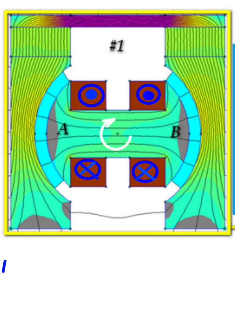

      Your red and blue dynamo model isn't a very good design. It appears that half of the armature turns are ineffective. Therefore 250 instead of 500 should be used in the generated voltage calculation.
      The upper two coil segments indicated with blue circle/dot are enclosed by the main magnetic circuit, or anapole, passing through A & B on the rotor, whereas the lower two, blue circles with cross, are not inside the main flux loop.
      Except for the single line in your FEMM connecting the bottom of the stator. If there is a flux linkage there, it will render the lower armature copper (circles with cross) counterproductive.
      Poor design.

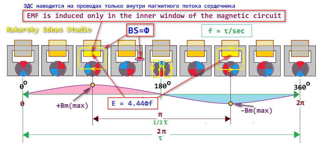

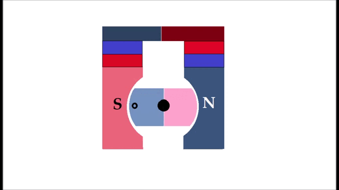

      • This illustrative model of an alternator is inefficient, but it is a model that shows students a real example of an alternator with a core. In a real armature, there are two windows (two focuses) or in a real turbo generator, both magnetic anapoles also participate with maximum generation efficiency.
          If we consider the components of the magnetic circuit and the EMF diagram, we see that the induction of electromagnetic force occurs when the cross-section in which the magnetic circuit is closed changes. Induction is induced only in the wire that is in the focus of the changing magnetic circuit. At the same time, with a complete closure in the minimum or maximum value, the cross-section in which the magnetic circuit is closed, the induction of EMF is not induced. The main element in this case is the change in the cross-section of the conducting circuit in which there is a closed source of constant magnetic field.
          Ф = Bm*S, where S = a*b changes
          [/QUOTE]
          Rakarskiy,
          Your latest example contradicts the above observation, doesn't it?

          • This does not contradict, because these are two different systems. In addition, if you simulate an armature with a current that creates its own magnetic field of the armature, then everything works according to the algorithm of magnetization and remagnetization of the armature during rotation. I have already made the appropriate modulation. Rotation at idle is different from rotation with a current in the armature winding. I will make a video with explanations and animation.
ID:	515835Click image for larger version
            As for the drawing that you tried to attach to the moving armature, in this case the algorithm of my previous slide will be executed, a classic simpler AC generator with a moving magnetic rotor.
            ​​​​​​In the video we will also analyze this option.
            Click image for larger version  Name:	155718493.jpg Views:	0 Size:	170.5 KB ID:	515833
            Click image for larger version  Name:	2023-11-09_085408.jpg?_x_tr_sl=en&_x_tr_tl=uk&_x_tr_hl=ru&_x_tr_pto=wapp.jpg Views:	0 Size:	124.5 KB ID:	515834
              Why you refer to it as "main element"? It is nothing more than saliency There are salient pole dynamos and non-salient ones. But the main "element" is changing magnetic flux influencing armature conductor(s). Look it up.

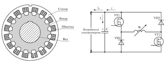

              • There are also interesting electromagnetic generators - PARAMETRIC! They do not have alternating current, only pulse current. And the essence is still the same, the cross-section of the core changes from rupture to complete closure. And a conductor cannot cross magnetic lines in general, even in a dream.
                Wise Eye OverUnity: Parametric Pulsed Generator
                VALVE INDUCTION GENERATORS
                Currently, work is underway to use valve-inductor generators (VIG) as an autonomous energy source for passenger cars, which increase power, have better specific indicators and improve reliability and maintainability, as well as reduce the consumption of non-ferrous metals and structural materials.
                VIG refers to parametric electric machines, the principle of its operation is based on the periodic change in the inductance of the stator winding depending on the angular position of the rotor. The magnetic circuits of the stator and rotor have protruding poles - teeth. The stator slots contain a concentrated winding, the rotor teeth are not covered by the winding and serve to close the magnetic flux. With this design, the inductance of the stator winding changes from the maximum value when the axes of the stator and rotor teeth coincide (tooth-tooth position) to the minimum value at the tooth-slot position. The shape of the winding inductance curve is affected by the degree of saturation of the magnetic circuit in addition to the angular position of the rotor.
                The configuration of the teeth and depressions is selected so that the difference between the maximum and minimum inductances of the winding, depending on the angle of rotation of the rotor, is as large as possible. This contributes to the efficient electromechanical conversion of energy, since the electromagnetic torque and, ultimately, the energy supplied to the electromagnetic circuit of the generator depend on the rate of change of inductance.
                The generator operates as follows (Fig. 1). Mechanical energy is supplied from the wheel pair to the generator shaft. When the power source (excitation) is connected at a moment close to the coincidence of the stator and rotor teeth of the excited phase, current begins to flow in the stator winding along the circuit: C—VT1 — W—VT2—C. The energy accumulated in the capacitor C serves as an excitation source. Under the action of the mechanical torque applied to the VIG shaft, the rotor teeth move away from the stator teeth. In this case, the winding inductance decreases, which is accompanied by the induction of EMF in the stator winding in the direction coinciding with the current in the winding. The current flowing in the winding under the action of the induced EMF is added to the excitation current, increasing the reserve of electromagnetic energy in the VIG circuits.
                Click image for larger version  Name:	2022-11-14_095122.jpg Views:	0 Size:	29.3 KB ID:	515839
                Fig. 1. Operating principle of a valve-inductor generator
                When the rotor, moving under the influence of external forces, reaches a position close to the tooth-groove position, the semiconductor switches VT1 and VT2 are closed by the signal from the rotor position sensor. The energy spent on excitation and obtained by electromechanical conversion from the external mover (wheel pair) enters the external circuit: C-VD1-W-VD2-C. The closed state of the power semiconductor switches (VT, VT2) falls on a strictly defined area of ​​the angular position of the rotor relative to the stator - the generator mode area. This area is determined by the rotor position sensor, the signal from which is fed to the control system.
                Switched Reluctance Generators | kaskod.ee
                Click image for larger version  Name:	2022-11-21_120222.jpg Views:	0 Size:	21.6 KB ID:	515840
                Click image for larger version  Name:	2022-11-21_120831.jpg Views:	0 Size:	40.7 KB ID:	515841
                Something like that, all education about electromagnetic generation is lying. Engineers don't listen to them, so they build various electromagnetic generators.

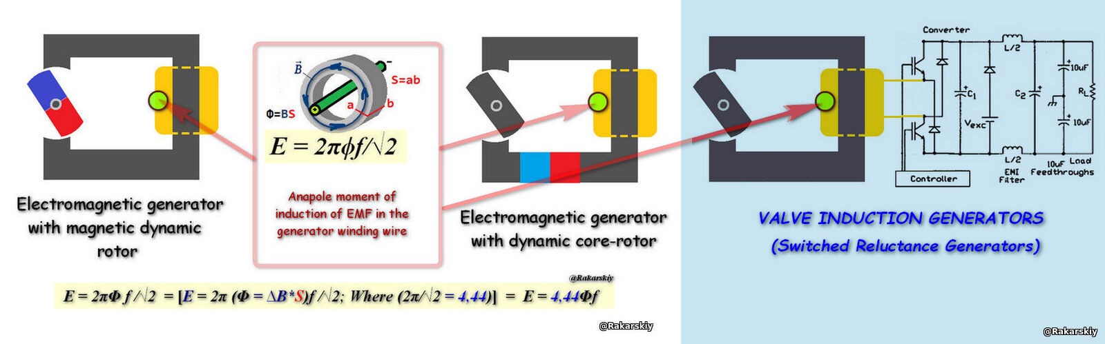

                • My slide requires an additional type of electromagnetic generator. All induce EMF on the phenomenon of changing the Anapol moment.
                  Click image for larger version  Name:	834086851.jpg Views:	0 Size:	133.7 KB ID:	515843

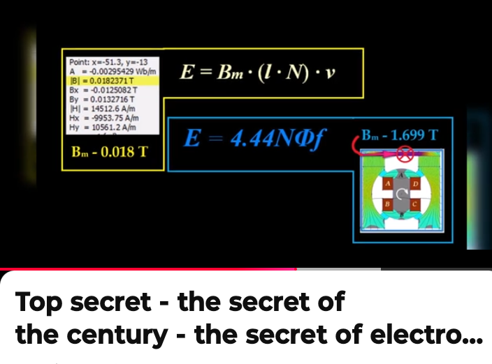

                      • Top secret - the secret of the century - the secret of electrodynamics

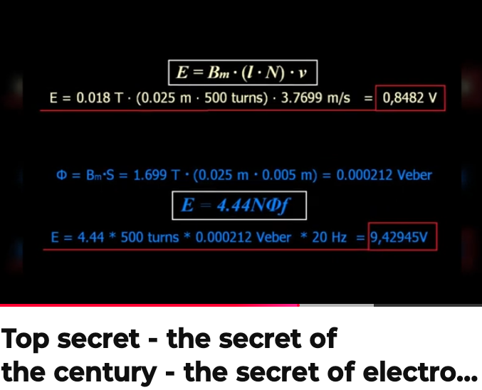

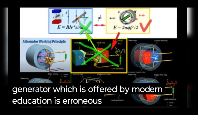

                        • Mr. Rakarskiy,
                          I noticed that the methods or equation parameters that you used differ in important ways which invalidates your conclusion based on comparison of the calculations.
                          Those equations from screenshots lifted from the video:
                          In the first instance, flux density (Bm) and velocity (v) are used, making it an instantaneous calculation. In the second equation, peak magnetic flux (Ф) and frequency (f) are used, yielding the calculated RMS value.
                          Click image for larger version  Name:	Screenshot_20250320-203348.png Views:	0 Size:	204.2 KB ID:	515848
                          So you conclude that "modern education" is purposely teaching "erroneous" facts and formulae, our society knows it and keeps it "top secret", from your obvious miscalculation. You really should take my advice and look it up, meaning study the science and develop true understanding of fundamentals then increase quality of your methods and analyses. You need peer review of your articles prior to publication, especially those for sale, unless labelled fiction.
                          • Modern education has a misconception of the motion of charged particles. Therefore, taking the phenomenon of analogous (toroidal) torque, discovered in 1957, as the induction of electromotive force contradicts this false concept. Faraday was able to induce the analog torque phenomenon by experimenting with an induction ring, and modern education generally lies about the Pixie generator.
                            The calculations were made for the maximum point of EMF induction, so your wandering once again emphasizes the falsity of your diploma.

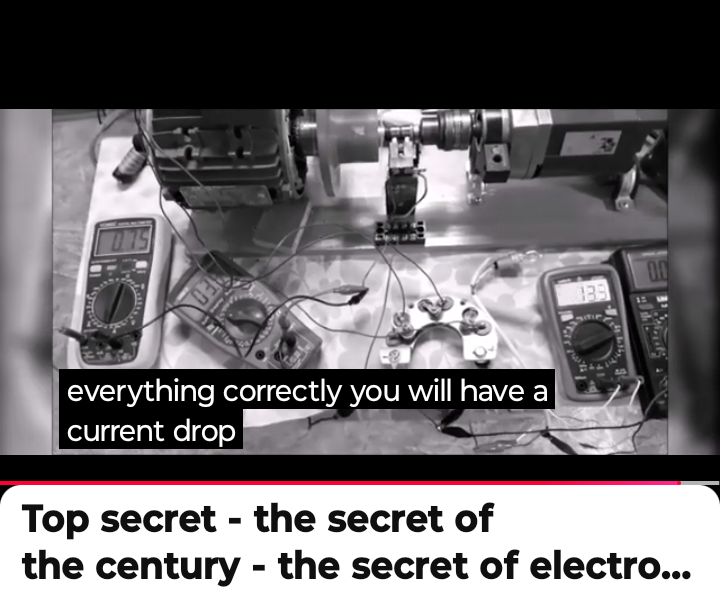

                              Rakarskiy,
                              There are millions of generators proving what I say. Prove what you claim. Take the experimental model which you describe and is shown operational towards the end of the video and demonstrate Over Unity. Instrument it, load it and simultaneously display measurements showing real power output which is in excess of power input. Some tests were run. Why wasn't a output/input power test done and included in the video? I know why. It's the same reason Turion can not prove his Over Unity claim (for like 7 years now). These are false claims.
                              • ) Dear opponent, I don't need to prove anything to anyone. I shared information even about the simplest mechanism for assembling a test model. The choice is a personal matter. I have other projects that are already in progress. By the way, I don't recommend doing this in front of an audience that occupies seats with pop-food to observe those who have already taken up the task. Let everyone do it themselves, or even better - in a group where the participants have different knowledge and skills that can be used in a collective solution to the problem. It is easier for a group to do one thing for everyone than for one person to do it for everyone.
                                I'll make a test model soon, I've already found the main anchor and stator, very small, just right for demonstrations.
