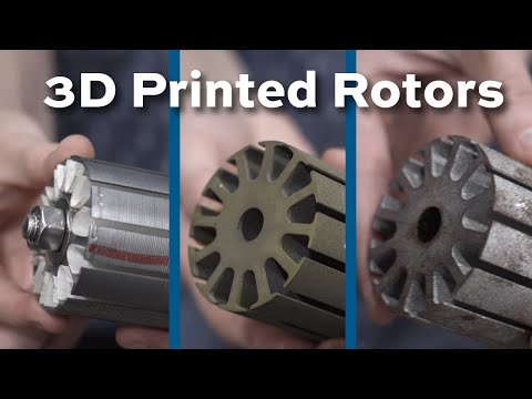

                  • 3D printed motor rotors

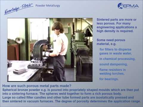

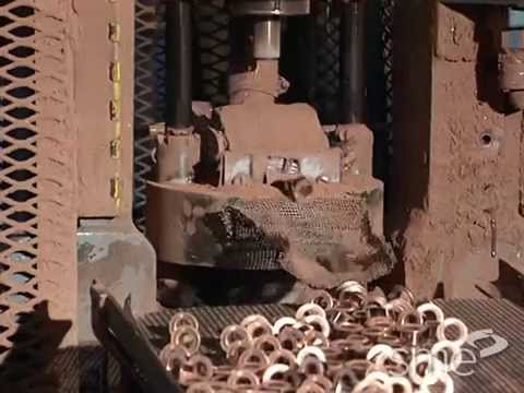

                          • making powder parts then go into a forge heating till red
                            • Story time. A 50 ton bottle jack cost $100 bucks and a propane forge is cheaper.
