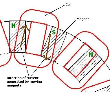

I think it is important to understand electron direction when a magnet passes over a coil. The attached picture should demonstrate this.
As a result (assuming you want three phase), I think you should wind all your coils in the same direction but the size and spacing of the coils are critical so that the magnetic fields line up.

I am not an expert, but I have done some research and have put in Solar Panels, Wind Generator, along with large battery bank and a High Amp Altenator on my sailboat. That gives me some experience.
With 3 phase AC, you can use an ordinary 3 wire outdoor extension cord from your generator to your bridge rectifier. AC will transmit over a long distance with 14 ga extension cord. DC will need welders cable to go the same distance. Your bridge rectifier should be close to your batteries and grid tie inverter while your generator could be outside somewhere.
You would have a multiple of three coils to go 3 phase. Either 3, or 6, or 9, or 12, etc. EX: If you have nine coils, 1,4,7 are tied together, 2,5,8 are tied together, and 3,6,9 are tied together.
As far as your picture of your coil and magnet setup, you have the spacing right where north is on one side of the coil and south in on the other side of the coil (assuming N,S,N,S,N,S setup on your magnets). You can add more magnets and shorten the width of the coils. Basically, maximize the number of magnets and coils which should maximize the current.
