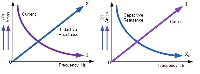

        Good to see you posting here. But you have me confused. I admit I didn't take time to look up everything before replying to Bob. Do you agree that inductive reactance goes up as the frequency goes up Yes I do, there is a linear proportion here, the higher the frequency the higher the inductive reactance becomes till the coils self resonance is reached.
        and that capacitive reactance goes down as the frequency goes down. No, I do not agree, capacitive reactance goes down as the frequency increases, there is an inverse proportion here to frequency.
        In other words if you connect a capacitor to DC as soon as the capacitor is fully charged it is not going to pass any more current so you could say the capacitive reactance is infinity. Yes. And as the frequency goes up the capacitor begins to pass more and more current. Yes and this means that its capacitive reactance goes down at the same time to a lower and lower value to pass more and more current. And of course everything is just the opposite for an inductor. Yes, till reaching self resonance for the coil, beyond that the coil starts behaving as if it were a capacitive reactance.
        So I am confused as to why you said below the resonant frequency the reactance would be inductive and above would be capacitive? Can you please explain the reason for you saying that?

        • Thanks for your explanation gyula. I do see in my post you quoted that I made a typo. Where I said the capacitive reactance goes down as the frequency goes down I meant to say as the frequency goes up. I was pretty tired when I typed that. Sorry about that.
          Ok, so you are saying in a parallel resonant circuit that below the resonant frequency the reactance is inductive and above the resonant frequency the reactance is capacitive because below the resonant frequency the inductor is carrying more of the current and above the resonant frequency the reactance is capacitive because the capacitor is carrying more of the current?
          I would consider the part of the circuit that is carrying the lesser amount of current to be the one that is more reactive. So I guess it all depends on how you want to look at it.
          Since Bob was asking in reference to a series connected bifilar coil the parallel circuit analysis is more the correct one.

          • See my comments in blue within your text.
            Gyula
            Yes, that is okay.
            Well, in reactive networks I consider a component carrying the lesser current has less overall effect in phase shift than the one carrying the higher current, hence a component with lesser current is less reactive, this is how I see this.
            To be fair, we need to consider a series resonant circuit too (I focused on a parallel one so far). Starting from DC and from low frequencies upwards, the capacitor surely has a huge reactance in this range so a series circuit must behave as a capacitive reactance which decreases as we increase the frequency. The coil in this scenario is a series short ( quasi a piece of wire) at DC and at the low frequency ranges i.e. has very low reactance, then its inductive reactance gradually increases as we increase frequency till we reach resonance. Beyond resonance the effect of the capacitive reactance start diminishing as we go up in frequency because Xc will be lower and lower.
            To sum up: a series LC has capacitive reactance below the resonant frequency (input current leads voltage) and a parallel LC has an inductive reactance (input current lags voltage) below the resonant frequency.
