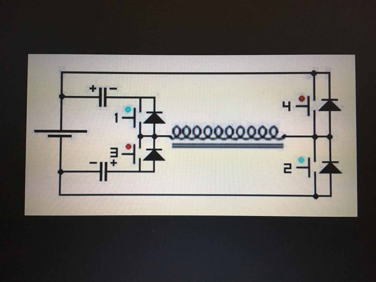

      • Single battery circuit
        Has ANYONE built the single battery circuit we posted and compared run times to just running the motor straight off the battery?
        • Hi Dave. I’d be keen to have a go at that. It’s multiple battery banks that make Tesla switch/3bgs systems impractical for electric cars, bikes, planes etc.
          Can you post the page number or date or if it was fairly recent I’m happy to look for it. I was thinking about using caps with a brushless ac motor like in the pic recently. Switches 1 and 2 close, the motor coil is energised for one stroke, then 1and 2 open. 3 and 4 close, energising the motor coil for one stroke with the current reversed. 3 stays closed, 4 opens and 1 closes with a brief overlap to recharge the source battery. 3 opens, 1 stays closed, 2 closes and repeat. The diodes are the built in to most semiconductors ones or maybe add speedy diodes like fr302’s across the switches. They direct the switch off spikes to one cap at at a time provided the right switch opens first. maybe a booster could play a part as well. I haven’t checked it all over yet For flaws or conflicts. It’s a concept in its infancy. Okay, for a start it looks like the diodes on 1 and 3 would have to be blocked with additional diodes or some other way. And without a booster this still needs 24v to drive a12v motor, so no bulk weight saving over a 2bgs. For a mobile application a booster or 2 would be the big weight saver.
          Cheers.
          • Single battery system
            If you have the stuff, give this a shot. It's as CHEAP as you will get.
            Post #3883, 7/13/2018
              I did. Posted data.

                    Turion,
                    I was attempting to be objective and completely unbiased so I just presented the data. With that it is easy for anyone to calculate system efficiency and draw their own conclusions, or suggest further investigation, which I would have, could still do, although the set-up has been torn down. At the time I did inquire of you what your results were, what the objective of the system was and what to do further. But you know how that discussion went.
                    I still feel it is in the best interest if I keep my opinions to myself and let the data stand. What do you think of my results (system efficiency)?
                    • Thoughts
                      Your data
                      Boost module 1
                      Input 12.11V, 5.27A, 63.8W
                      Output 27.67V, 1.99A, 55.06W, 86.3% efficient.
                      Boost Module 2
                      Input 12.4V, 1.28A, 15.7W
                      Output 14.13V, 1.01A, 14.27W, 90.9% efficient.
                      Just looking at the data that you collected doesn't tell you anything about what is possible, or even exactly what is GOING ON with this system. That's why I asked for your opinion. All you really did was measure what is coming out of the two boost modules. As to the data, I think it's probably pretty close to what I would expect. I am usually getting close to 93% with my boost modules. I have some expensive ones that push that number up several % points, but that isn't important. With the little ones I put a couple in parallel so I get a LITTLE bit better efficiency, but like I said, that's not critical.
                      The only way to tell if you really HAVE something with this system is to run your modified motor connected to a load directly off the battery until it is run down, and then charge the battery back up and run it on this system. See which one lasts longer.
                      When I run this setup, I have a second motor shaft connected to the first, rectify the output of the second motor (as a generator) and measure watts out to a load. That's how I calculate which system gives me MORE output from the run time of a single battery.
                      All this simple circuit was designed to do was prove, with A SINGLE BATTERY that the energy does not HAVE to be consumed by the load. It CAN be reused. Now this little system is just proof of concept.
                      You will notice that boost module 1 is running in a conventional manner, which WASTES energy, but it is necessary for the purposes of this demonstration. Normally, I would NEVER run anything this way as it is so wasteful. I will also say that if you do not use the modified motor, the setup will NOT work, because the modified motor pulses the battery like a battery charger does. There is a pulsed input going into the second boost module, so there is a pulsed output coming out of it, even though the boost module itself pulses, it is at the wrong frequency, so the correct motor is necessary.
                      That's all this system was designed to do, give you a longer run time. Other systems are designed to do much more than that, but ya gotta start somewhere.

                        • Single battery circuit results
                          With system = 3 hours.
                          Straight from battery = 54.6 hours.
                          Just one test on one system. Not to be considered conclusive. Disappointed not to see anybody else running this test.
                            I ran that system for 3 hours. That took 333 watt hours from the battery. If I would have run a 6.1 watt load directly from the battery, it would have run for 54.6 hours.
                            And with a converter between the battery and motor, those pulses are blocked.
                            What's your opinion of the real data?
