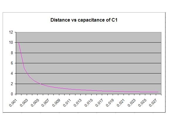

4) Entering into the time domain, the platens of capacitor (C1) will beg separated, causing a decrease in capacitance via the equation:
As the distance between the plates increases, the capacitance of (C1) moves asymptotically towards zero.

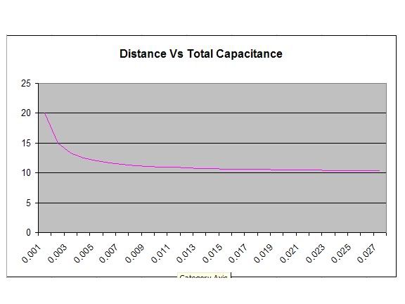

5)Because of the decrease in capacitance (C1), with charge kept constant across the combined capacitor of C1 and C2(law of conservation of charge: Charge conservation - Wikipedia, the free encyclopedia ) The capacitance across combined capacitors (C1 & C2) will decrease and the voltage across combined capacitors (C1 & C2) will increase.

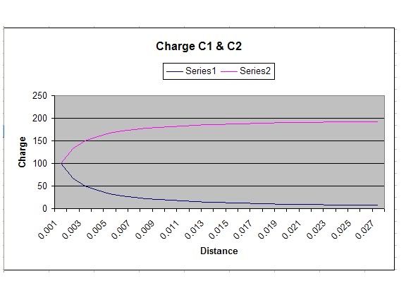

6) The rise in potential across C1, will cause a potential difference between C1 and C2, meaning they are out of equilibrium. Because of their tendency towards equilibrium, charge will move from C1 to C2 (the sum of both will always equal the total charge initially in the system). Because there is a conduction path through the load, the capacitors C1 and C2 constantly equalize, and as the plate are separated, a new higher voltage is attained across both capacitor simultaneously. This is shown in the graph below.
Here the values for the capacitors are 10 farads initially, then C1 decreases as discussed. Here we have capacitance of combined capacitor C1 & 2. It starts at 20 farads (parallel reference frame) and as C1 tends towards zero, the total capacitance moves asymptotically towards 10f.

The charge distribution across caps (C1) and (C2) changes with respect to time, meaning charge has moved through the load in the equalization process. With initial conditions of C1= 10 Farads and C2= 10 farads, both have an initial charge of 100 coulombs on each condenser. As the capacitance of C1 (blue line) decreases, so does its charge, while the charge across C2 (pink line) increases. The sum of both at any one moment equals 200, or the initial condition of charge once again satisfying the laws of conservation of charge.

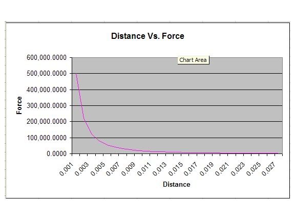

Finally we have the force between the plates of condenser (C1) as a function of distance or time:
This graph follows the force between the plates of condenser (C1) as they are moved apart and the voltage across both capacitors increases simultaneously. As you can see, while close, there is great force and while they separate, the force decreases. The behavior is that of an exponential decay, much like an inverse square field.
